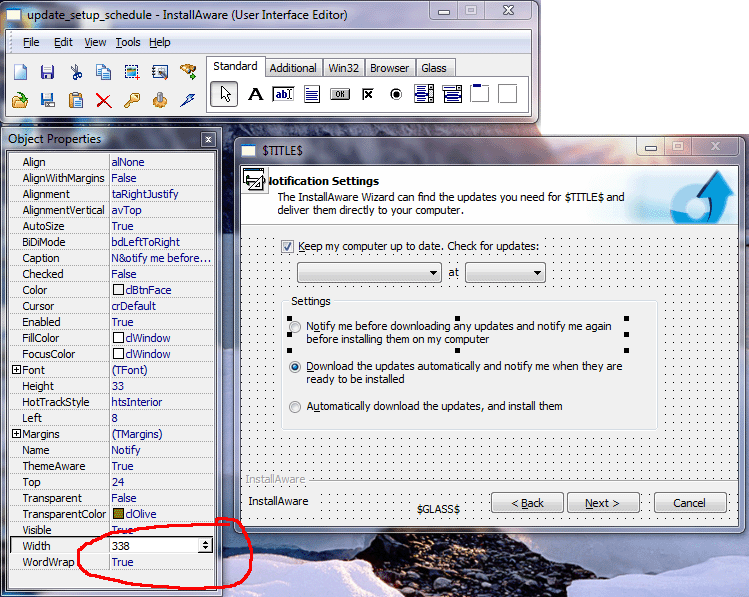

#1 You can easily fix this:
a- load your project in IA, switch to "MSI Code" view (select the "MSI Code" tab from IA top ribbon).
b- locate the Dialogs node under the left tree view pane and double click the "update_setup_schedule" dialog, in order to open it with the IA Dialog Editor.
c- Once the IA Dialog Editor is displayed, select the Label Control which displays the incomplete text and proceed to modify the Label control properties as follow;
NOTE!
First set the "WordWrap" property as TRUE and then set the "Width" value. I used 338 px value ... but you can change it as you like.
d- Once completed save your dialog changes and rebuild your project.
Anyway, I'll log a note to our dev team in order to have this fixed in future.
NOTE!
