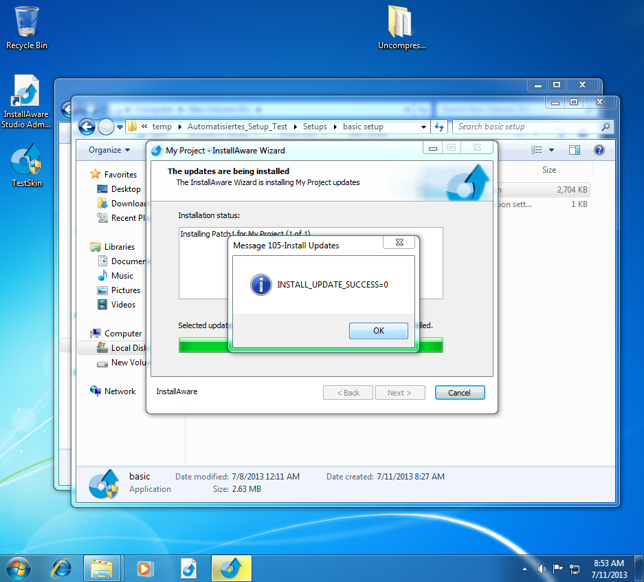

Re: Web Updates does not work with installAware16 on windows
Dear Sarah,
I have tested your package as by your steps and it works fine.
This is the screen-shot of the result message-box;
Honestly, I suppose the problem you had could be caused by the patch execution.
What you receive as return code from the Run Program execution, it is very probably, the result of the patch package execution and not a failure of the command execution itself.

For your convenience, you find attached the screen-shot sequence produced when I tested your package.

If you are using a different IA version and to be sure that your error may be caused by an issue with the activation of your IA product, please try the following;
- Completely un-install your IA 16 installation.
- Re-install IA 16 once again using the last update available (IA 16.07)
- Re-generate your personal license file, BUT LEAVE YOUR IA INSTALLATION AS TRIAL (DO NOT ACTIVATE IT - YOU WILL ACTIVATE LATER).
- KEEP IN A SAFE PLACE THE GENERATED ACTIVATION FILE AND THE IA 16.07 INSTALLER FOR LATER USE.
Finally;
Repeat the steps (exactly) I used the rebuild both projects.
Test your builds and report your results.
I'm not able to reproduce your issue and I can assure you that doesn't exist a problem with handling patch projects with IA 16 (... otherwise, this forum should full of similar issues).
How I have tested using IA 16, the original project available from ( ... previously edited by me);
http://www.installaware.com/forum/viewtopic.php?f=2&t=9414
- Builded the Project "Version1000"
- Updated the Patch reference to "Version 1.0.exe" in project "Version1010"
- Builded Project "Version1010"
Finally;
- Builded the Project "Version1010" patch.
I may suggest you to first try the builded packages included with the attached project, in order to verify what happens if my build are used with your target machines.
I used the last InstallAware version available (IA 16.07).
Finally;
- rene.rar
- (6.63 MiB) Downloaded 407 times
Hello Francesco,
i downloaded your attached .zip file and I have done the installation test on 4 target maschines (with your builded files), and i get the same results like described in the post of "Wed Jul 17, 2013 4:18 am"! The installation of "Version 1.0.exe" works on all target machines(4). The patch "Version 1.0.1.0.exe" installation only works on 1 machine.
When i install the patch, which you find in the ORIGINAL site "viewtopic.php?f=2&t=9414", on all machines the patch is installed successfully. The unsuccessfully test with your builded "Version 1.0.exe", "Version 1.0.1.0.exe" shows that the problem can not come because of the installAware Version on my computer, or because of a licence problem. The problem is general. Anyway i deinstalled the version on my computer, reboot and install again without, activation, and i get the same problem again. The problem comes always while the patch installation '"" is not a valid integer value'... The problem comes only with installaware 16. with the testversion 15 i never had this problem. I don*t understand, why the problem comes on some machines and on some not...Do you have any idea?
Best regards
Sarah
Best regards
Sarah
Dear Sarah,
honestly, It is really strange ... I'm not able to replicate the same.
I widely tested the posted packages with several OSes.
Can you please contact me at; support@installaware.com .
