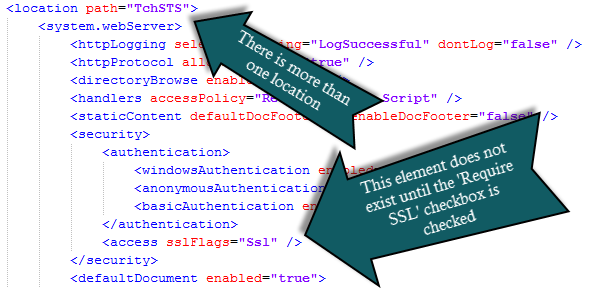

What am I doing wrong?
I am testing on Windows 7, the install will eventually be run on Windows 2008 R2
I cannot set the flag to Require SSL. I have read the InstallAware documentation. I have reviewed my application.host.config file. I have selected 'Use IIS 7 Processing'
Using InstallAware Studio 17
Can't set AccessSSLFlags
- ss1.png (14.95 KiB) Viewed 5723 times

That link was very little help.
I understand what is being said however, it seems to directly conflict with the InstallAware documentation. So do I have to use the "system.webServer/security/access‐>sslFlags" syntax or is it 'automatically mapped' when I use 'AccessSSLFlags'?
If I have to use the IIS7 configuration path (system.webServer/security/access‐>sslFlags) how do I identify the correct location, is it "[location:path=$Website$]/system.webServer/..." or something different?
As you see below <system.webServer> is within the <location> element and there is more than one <location> so simply setting the value to "system.WebServer/..." will not access the correct website. Also, do I set the value to 8 or Ssl or "8" or "Ssl"?
Please provide me with a helpful response.
Thank you.
Thank you.
Re: Can't set AccessSSLFlags
Dear Bobkain,
I am not an IIS expert, but for what I understand by the InstallAware documentation in accordance with Microsoft documentation, if you don't use the "Use IIS 7 Processing" mode with the command, the given IIS6 Metabase Property (if within the list) will be automatically mapped to the IIS7 Configuration Path.
So if you pass with the command the IIS6 Metabase Property "AccessFlags", this will mapped to the respective IIS7 Configuration Path.
Anyway, this is not what InstallAware says, but what Microsoft reports with its documentation.
You should also verify, with consulting the appropriate Microsoft documentation, if anything as been updated.
I may suggest to you to have a look at the following link, where an exhaustive Microsoft documentation and samples are available
http://www.iis.net/configreference/syst ... ity/access
Note that with the above documentation, along with all the samples available, it is described how to process IIS settings from ccommand line.
If you still have difficulties with the IA command, you can simply use the IA "Run Program" command to execute the "AppCmd.exe" CMD line tool whitin your script.
Used the AppCmd.exe approach.
Worked great.
