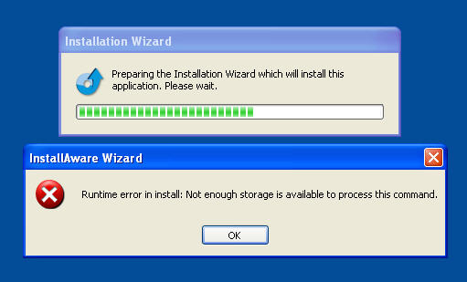

Recently upgraded from IA15 to IA17.0.4. I believe the problem regarding compression still exists, at least on Windows XP. I am not able to replicate this error on Windows 7, Vista, or Windows 8.
My main setup calls a second setup prior to the Finish screen. Both setups have been updated to include LANGUAGE=English compiler variable, and both have been recompiled with IA 17.0.4 using "Best" compression.
The main IA setup calls a second IAs Setup using Run Program $TARGETDIR$\AnotherSetup.exe
As the second setup is decompressing I receive the error: Runtime error in install: Not enough storage is available to process this command. Also included a screenshot. If I run that second setup from outside the main setup (silently or interactively), no problems.
Any help is appreciated.
- NotEnoughStorage.jpg (28.43 KiB) Viewed 41774 times
Re: IA17: Not enough storage to process: XP only
Dear JeffryPaul,
Honestly, I'm not quite sure that this problem could be related to a compression/de-compression error.
If for you it is a possible to send me those packages or a sample that replicates the issues, I'll try to verify it.
If you don't want to use the forum, contact me at; [email protected] .

GOOD NEWS! We finally solved our issue with XP. During my install I display more dialogs than might be common for a simple installation, which ours is not. We are actually running lots of commands to upgrade databases. In one case I had 77 calls to display a the same error dialog, passing it variables to handle the text which was displayed and then going to a label that cleans up the install. I replaced these with go to label error. This label is below the last line of code after Terminate Installation and does the call to Display Dialog error and go to label cleanup. My application will now run on XP. My co-worker who discovered the issue by commenting out all of the display dialog calls suggested that there may be a difference between how the memory is allocated on XP and other versions of Windows. In any case, we will now finally begin to deploy this application to our large and diverse customer base. Hopefully some of the rest of you can benefit from our findings.
