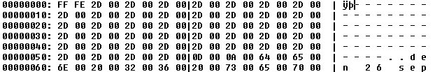

I am assuming unicode since there is a BOM of FFFE and each character is 16 bytes:

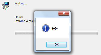

When read by IA the results are (in the messagebox):
When I try to append an empty line as a workaround the contents of the file is deleted.
