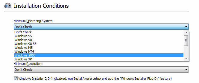

If I can only build installs that run on Windows XP and up, why let me choose the minimum requirements down to Windows 95? That would have been my first clue that I can't build installs for Windows 2000.
This has been left to maintain backward compatibility when using previous IA version projects within the new IDE.
