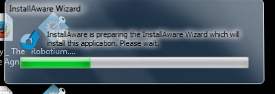

5. When I installing my product then starting screen (verifying content, and preparing installation screen) installaware text display. How to I change this installaware text.
I attach both the screen image .Please find the attachment.

- installaware text display
- Preparingscreen.jpg (17.09 KiB) Viewed 7080 times
- verifycontent.jpg (20.63 KiB) Viewed 7080 times
