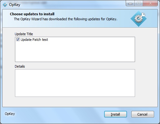

hello Support,
I am facing a problem in update process.

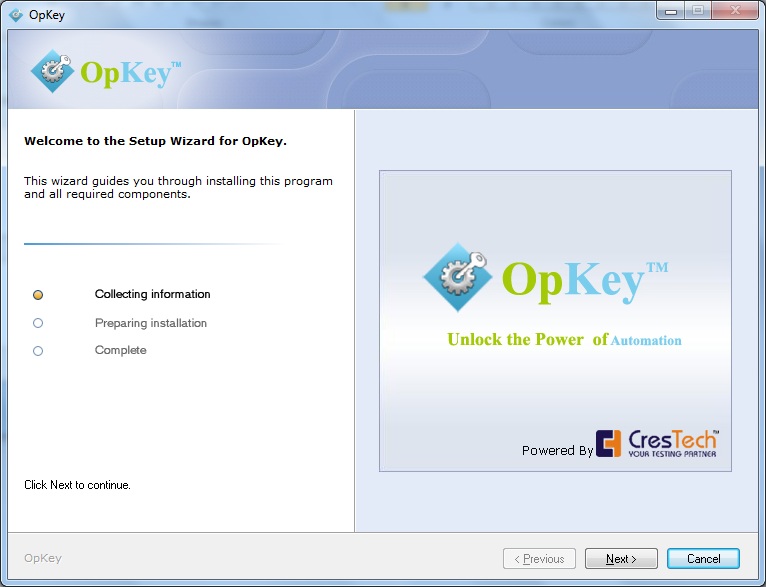

In update process after download process. Install window appear.
Then i click on install button . Installation start and Welcome dialog box appear. After that cancel the installation process .
Click on update button it show message no update are available.
I attach my project . Please see where is problem with the script and resolve my problem.
problem in updation
problem in updation
