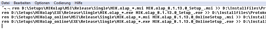

next bug: Always when I write Content into a new file (like a batch-file), the first line Begins with rubbish control characters. Please fix that.
Result in:
IA18: Control Characters in first line (Write into file)

Re: IA18: Control Characters in first line (Write into file)
Dear Heiko,
IA now uses UTF-8 (w BOM) Unicode encoding with text files, consequently the first three bytes are: 0xEF,0xBB,0xBF (=BOM) ... and not a bug.

How can I avoid that? Because I am writing Batch files with Content e.g
rename
miabuild
copy
and commands with that 0xEF,0xBB,0xBF are not working.
Okay I can write a dummy line at first with cls for example...but this is not the real solution for me
Dear Heiko,
...with adding an empty single "dummy" string line at the beginning of your file, it should work.
Ok thanks Francesco, it works this way...
You can Close that thread as it is not a bug, it's a feature
