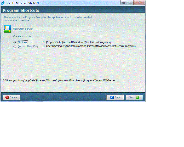

how can i get the line at the bottom (= $SHORTCUTFILESBASE$\$STARTMENU$ ) update at once if i change the EditField $STARTMENU$ or the RadiobuttonGroup $SHORTCUTFILESBASE$ .
If i press <Next> and then <Back> i'll get it, but i want to get that in a synchronous way (real time ...).
Thanx for help

- Installaware-1.gif (78.73 KiB) Viewed 3162 times

If I haven't missed your question, unfortunately it is not possible to catch when the Edit Box's text has been modified.
You should display that Edit box in a separate dialog and before to display your current dialog.
