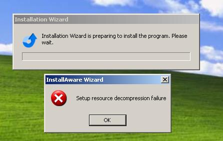

I am using your InstallAware v18 product.
I've had a problem with compressed or uncompressed installers.
"Setup resource decompression failure"

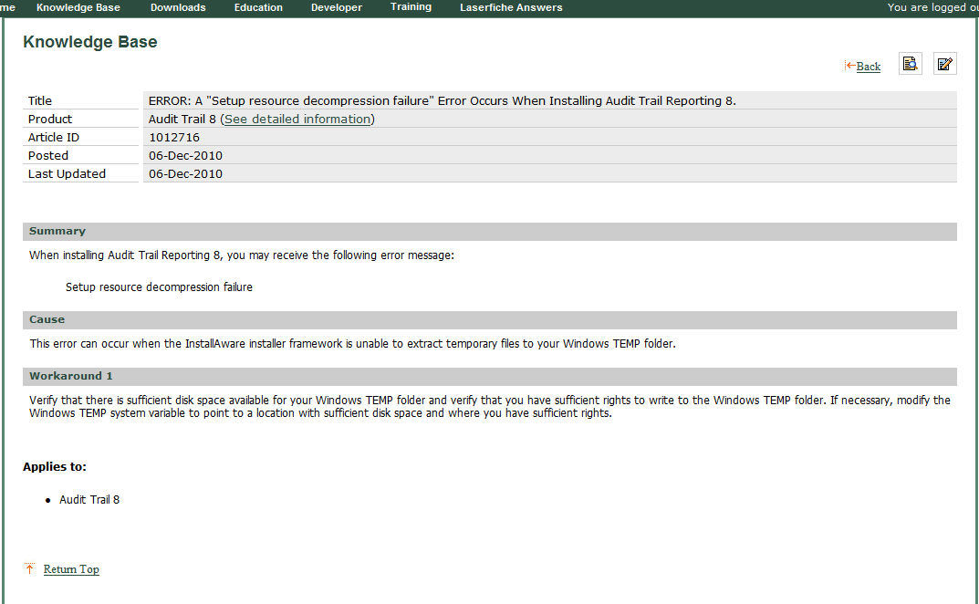

Attached is are 2010 images of something I found associating this with InstallAware.
Has to do with the TEMP environment variable.
Please comment.
Please comment.
thxs
- I get something similar to this
- InstallAware_NetSearch_SetupResourceDecompressionError.jpg (19.03 KiB) Viewed 13274 times

first of all, It is not clear to me your post;
Which registry? Which profile?
Anyway, If the cause is "not enough disk space" ... there is not much to do (the answer is already with your last screen-shot).
BTW, from where did you get that screen-shot?

Yes, I am using the InstallAware NATIVE installer.
As for a virus, I am working on a classified, closed government network.
Software installs are strictly controlled and the anti-virus measures implemented are extreme.
It is not a virus.
You have not answered my question about your past statements regarding a "bug fix" for this problem.
Do you know the nature of the "fix"?
That information might help me in my investigation.
If you search your posts for "Setup resource decompression" you will find many threads.
Please look at them and you will see where an IA employee makes reference to the "bug fix"
sincerely,
dmo
Re: Setup resource decompression failure
Dear Dmo,
As I have already said, Those posts have nothing to do with the IA version you are using and it was related to a specific previous version of IA.
That fix intersted a problem that it is not replicable with the current IA engine version ... because the curent IA engine uses internally a TOTALLY DIFFERENT APPROACH.
I hope that finally this clarifies the matter.
