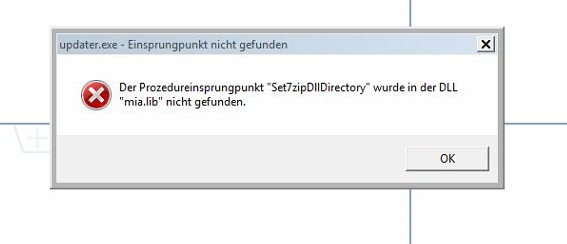

a customer reported an error:
"the procedure entry point "Set7zipDllDirectory" could not be located in the dynamic link library mia.lib."
Any ideas what could cause such an issue? Maybe the user merged different setups?
Message in german.

The error message sound like the user has the wrong mia.lib, so I think it could be that somehow the user is using a not matching mia.lib with the setup.exe (Maybe in temp Dir). But I have no idea how this could happen. So forget my thought. ;)

I could verify that the customer did merge different (uncompressed) setup versions. There was an old mia.lib parallel to setup.exe what caused the problem. Case solved ;)
