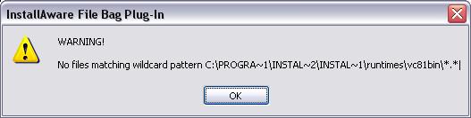

I seem to be having an issue with the new vc++ runtime.
Ok so i extracted the runtimes to the correct folder then restarted the IDE and i check the box (in Application Runtimes) MS Visual C++ Runtime 8.0 (includes ATL and MFC) Service Pack 1.
When i build the current project a message pops up (please see attachment). So i removed the pipe symbol from the end, then it seemed to build.
BUT when i run the installer package it seems to be the same as before and the application doesnt run because it couldnt find the vc++ libraries?
please help
please help
- Posts: 3452
I think the problem here is, you need to run the latest InstallAware setup to obtain the latest File Bag command. File Bag was updated to include support for exclusion masks and the pipe you are seeing is part of that, which the older File Bag does not understand.
