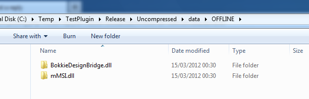

I did the uncompressed build. After the build I then copied all the missing files to the empty subfolder. For good measure, I also manually created the runtime folder and copied all the dlls into there as well. I still get the installation time error message. Attached screenshot shows what I copied.

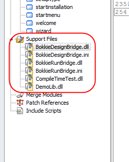

I tried adding the bridge dlls, ini files, etc (see screenshot) but nothing changed.
I'm still left with an empty folder in the Release build. I've tried copying foldes containing the files into the "right" place but it doesn't change anything. A little later, I'll 7z what I'm working with and I'll post it here for someone else to eyeball. It's really frustrating!
It brings me back to Francesco's comment about having to copy files in the CompileTimeBuild method. Has anyone actually done that? Right now, I'm relying on creating the folders myself after I've produced the output media but is that actually the right thing to do? I mean, I'm doing something after the build that IA didn't know about beforehand.
Christ23: When you were using MaxLogic's bridge, did they (a) work for you without plugin discovery problems, (b) did you do anything in the CompileTimeBuild method, and (c) did you have to perform any additional magic like pulling rabbits out of a hat?
