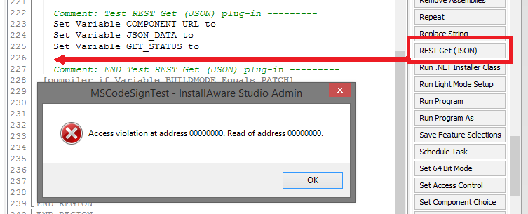

C# .NET plugin fails when dragging it to an IA script
- Posts: 32
- Joined: Mon Oct 29, 2012 2:27 pm
I have successfully compiled a .NET IA plug-in in C# named "REST Get (JSON)" using the .Net Plug-In Wizard template, including its installer that registers it in the registry. The Plug-In is listed in the Plug-Ins list (so I know the plug-in's registration in its installer works) in the IA IDE launched with a test IA project. When I drag the Plug-In to a point in the IA script, the following error message box is displayed:
This would imply that something has not been initialized but I can't seem to find where the error in my code is. Before I fatten up this post with my source code, has anyone seen this behavior before?
