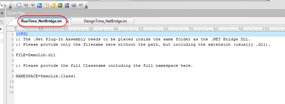

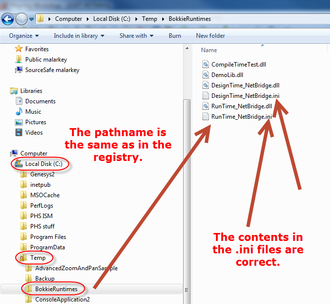

I've spent a bit of time trying to get the Bridge plug-in to work. I went back to first principles and created a plug-in using the IA NX project creation. I compiled the two .Net projects, etc. If I drag the plug-in into a new setup project it displays the test message successfully. When I build the setup I get another message box displayed which again, looks to be okay.
However, when I run the setup I get this error message "Unable to load plug-in library. Please rebuild your project and make sure all required plug-ins are installed."
I think I've done everything the right way but maybe I've missed an important step but I can't be sure. Has anyone used the plug-in created by IA to see if it works during all phases in the IDE, build, and when you run a setup that tries to use it?

Francesco, thanks for your help with it. The plugin template that comes with NX has two dotnet solutions and both compile clean. You don't need to change the source code. Where I think I might have a problem is the use of the two bridge dlls and ini files that describe the namespace and classes used by the plugin. There is a dll and an ini file for each of the IDE and runtime usage. They refer to the two dot net dlls that the template solutions create.
I'm not sure if the names of the files are important?
Do the six files have to be copied to another folder somewhere that IA looks for them?
I looked at the registry entries for some of the other plugins and I can't see anything I might be doing wrong. If I can work out how to get a very simple one working I'll write a tutorial document which might be of use to others like me.

I've tried copying the six files (2 x ini, 2 x bridge dlls, 2 x C# dlls) into various folder locations. No matter where I copy them I always get the installation time error messages.
This is what makes me think I have done something wrong because I can't get mine to work at runtime. I can't see anything obviously wrong.
Christ23 and Glenn: it seems to me yours are able to run during installation time? If so, what would explain the difference between yours and mine?
Francesco: You might have better luck than me!

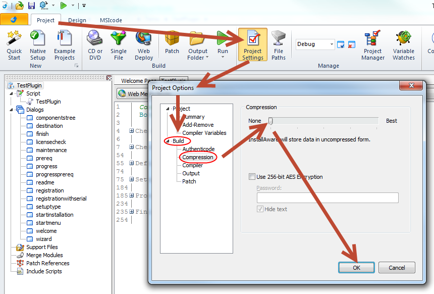

Dear bokkie,
are all your plugin dlls copied during the build?
To test it, do an uncompressed build and check if all the required files are available under the build folder of the project.
The full path to the folder where the plug-in must copy its build files to. At a minimum, the plug-in should copy its Run-Time DLL to this build location. The plug-in may also copy other files as needed (for instance, if the plug-in installs any files, it should also copy those files).
