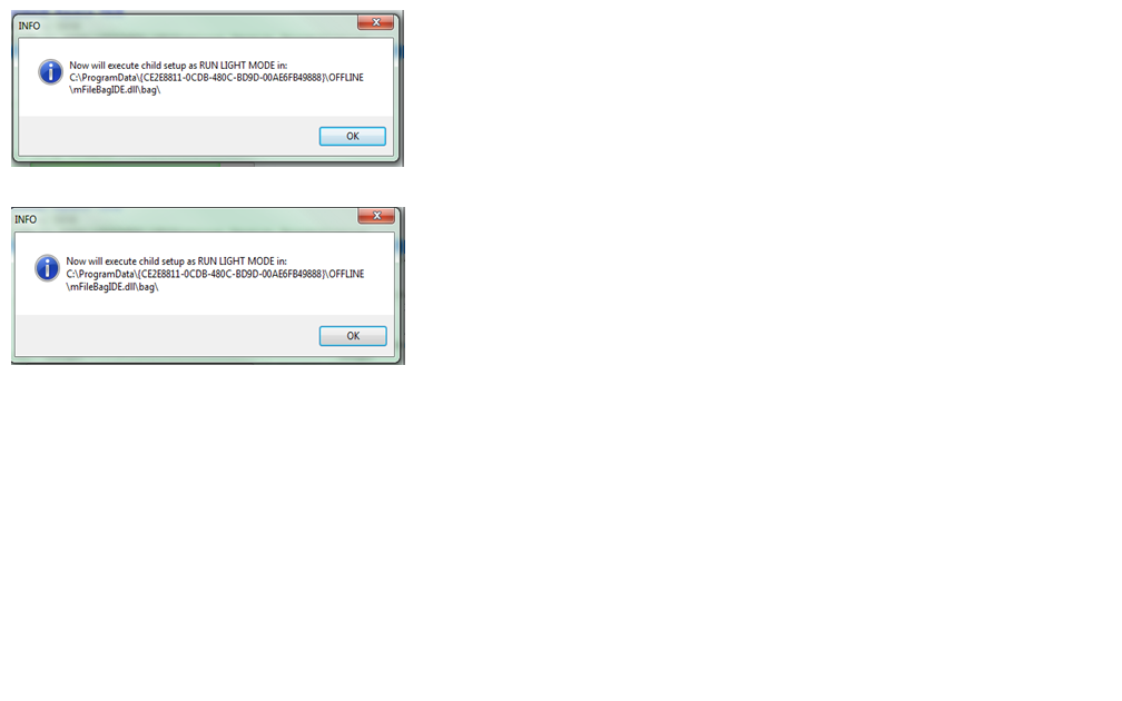

Postby Rulan » Tue Dec 11, 2012 7:09 am
That I do not understand... :?:
You said: "You can include with your script as many File Bag commands you want.
The file bag command creates a File Container folder at runtime execution and each command, points to a unique and separate folder."
I defined two filebags, and they are installed in the same path as it seems, with the root-name of the revision code by the motherfile, where the fielbags are defined... (look at the picture) :(
Do I something wrong? In my case the installation run, but what happens, when the installations have identical files-names?
regards
Re: confused: compiler NOEXE = TRUE
Postby FrancescoT » Tue Dec 11, 2012 12:13 pm
Dear Rulan,
please excuse me, I was wrong (... I'm coming older :roll: ).
You are right, the folder under File Bags files are placed at runtime, it is the same for all the File Bags you used.
However, because File Bag command can include sub folders, you could point to a folder wich contains several sub-folder ... in this case you can store identical files-names as well.
