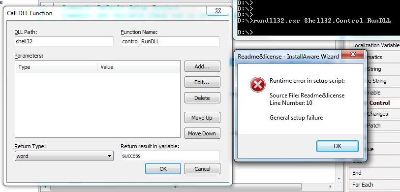

we tried to use "Call DLL"...
The following sample shows a Test_"Call DLL" with an Error-message... What do we wrong??? using rundll32.exe it works...
Path for shell32 or with or without .dll extentsion has no positive effects...

Re: Problems CALL DLL
Dear Francesco,
as I described above, there is no difference between full path and extention:
Parameter??? There are no parameter needed!!!!
1) THis worked fine under command line or also as "run program" code. Please try it yourself :

2) What do we wrong???? I read in this forum, that "call dll" worked similar like "rundll32.exe"???? Why is it impossible for us to get our example above running under "CALL DLL".
Our last try:
What can we do better? Can You give us an example, that works?

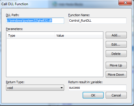

Thanks Francesco,
something happend, but!!!!!!!!!
Here we are....
I put your example and the only thing I did was to define an return variable (SUCCESS) inside the call dll routine...
A Messagebox displayed the SUCCESS and now .... tatata...
And that I do not understand...
Here we are....
Dear Francesco,
Your right ... Example worked...
But I got it, why I had problems...
You have to explicit define the Return variable before call dll is used. IF not, You get this error above.
Sorry about that mistake...
regards
regards
I'm happy you solved
... but anyway, it is not necessary to use a return variable with that function ... because it doesn't return a value.
