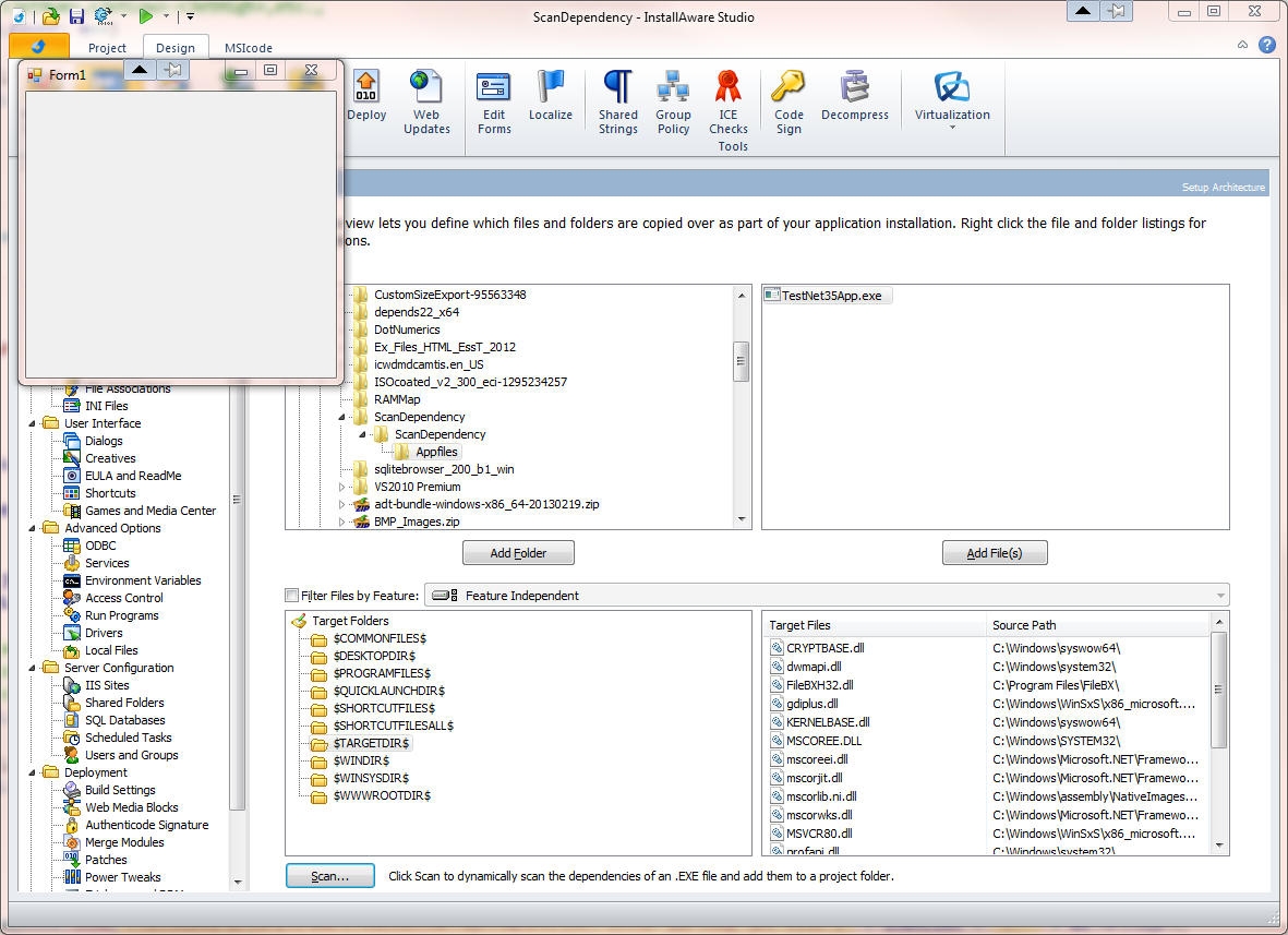

Re: Dependency scanning, am I missing something?
Yes, that project worked. See attached screen shot.
So, it seems that Installware is working on your app but not mine. Any ideas on what I can try next?
-Ray
-Ray
- 2013-06-12_0822.png (208.8 KiB) Viewed 33180 times
