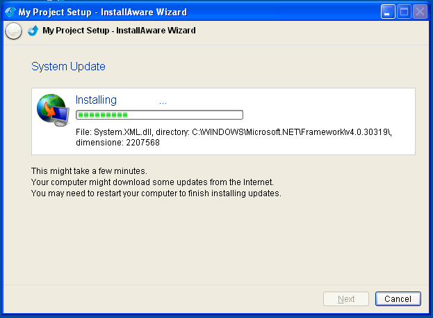

in addition to my previuos post, I missed that your Adobe AAMEE already produces an MSI file.
So I forgot to tell you about a more powerfull use of InstallAware that you could use.
The (Un)Install MSI Setup plug-in (included in every InstallAware setup by
default using even the minimum setup option) can run any MSI to install it
or remove it; and even capture the progress feedback and display it natively
inside the InstallAware setup dialogs as if it were its own.
Just adding the above code line in your script you have a very easy way of
running that file, which doesn't involve ugly/opaque command line methods at
all.
Using the (Un)Install MSI Setup provided command you can installs, re-installs, or uninstalls a Windows Installer setup.
A full Windows Installer setup command line may be specified and the progress of the Windows Installer setup will be captured and displayed as part of the installation progress (*See below screenshot).
As example this is the captured progress running a net runtime msi file.
Example:
Install/Remove MSI Package myfile.msi[ADDLOCAL=ALL] (get result into variable MYRESULT)
all.
