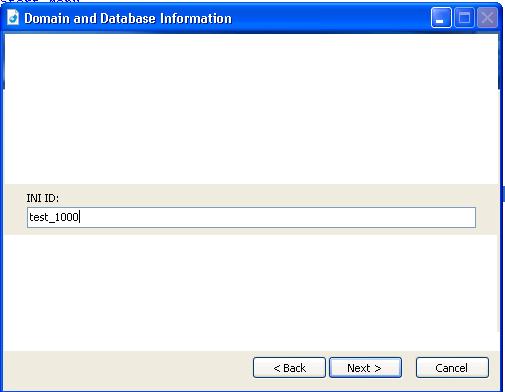

1 - User enters INI id which is stored in variable.

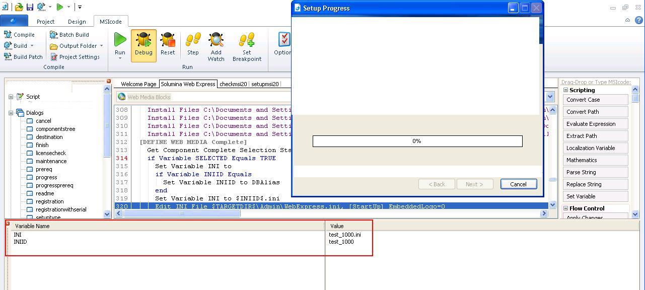

First of all, thanks for the quick reply.
But I have already checked the variable values of $INIID$ and $INI$. They are showing correct values. The problem is values cannot reflect in file name.
Here I have attached screenshot of variable watch. Please refer it for the variable value information.
Thanks again..

- Variable watch of variables $INI$ and $INIID$
- 2.JPG (114.91 KiB) Viewed 6320 times
