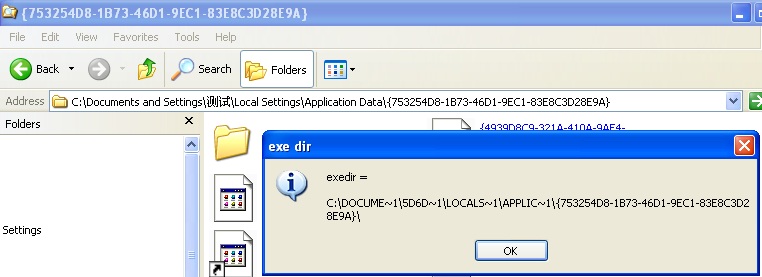

Could not reproduce. I used the name that was previously given here (测试). I tried with the user as Administrator and Limited. I tried with the original Admin account and the test user. I tried installing for all users and only me.
Is there anything special being done for this user account? Any special settings?
This post (one of few that has a 'resolution') suggests that there could be a permission issue or something:
http://care.dimdim.com/entries/117118-u ... ersion-5-5
But, that link does correlate to some degree what has been mentioned (it only is affecting particular users, so if you could log on as a user who's unaffected, you shouldn't have a problem).
By the way, on the account that I created, the uninstall link links to:
"C:\DOCUME~1\5D6D~1\LOCALS~1\APPLIC~1\{5224EC1F-5458-4977-87DE-7DBA4C3F07D1}\New Project.exe"
Can you verify what the link directs to in the case of your failures?

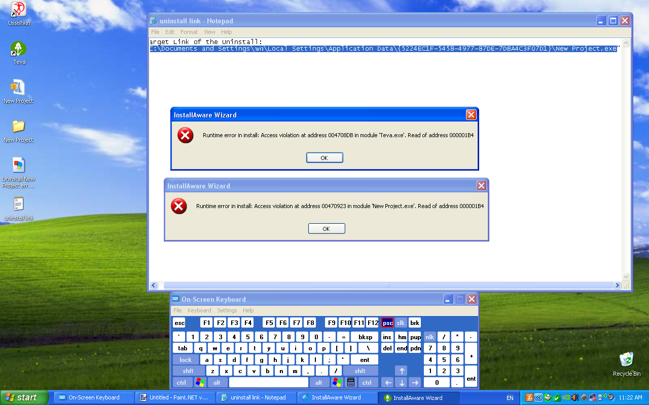

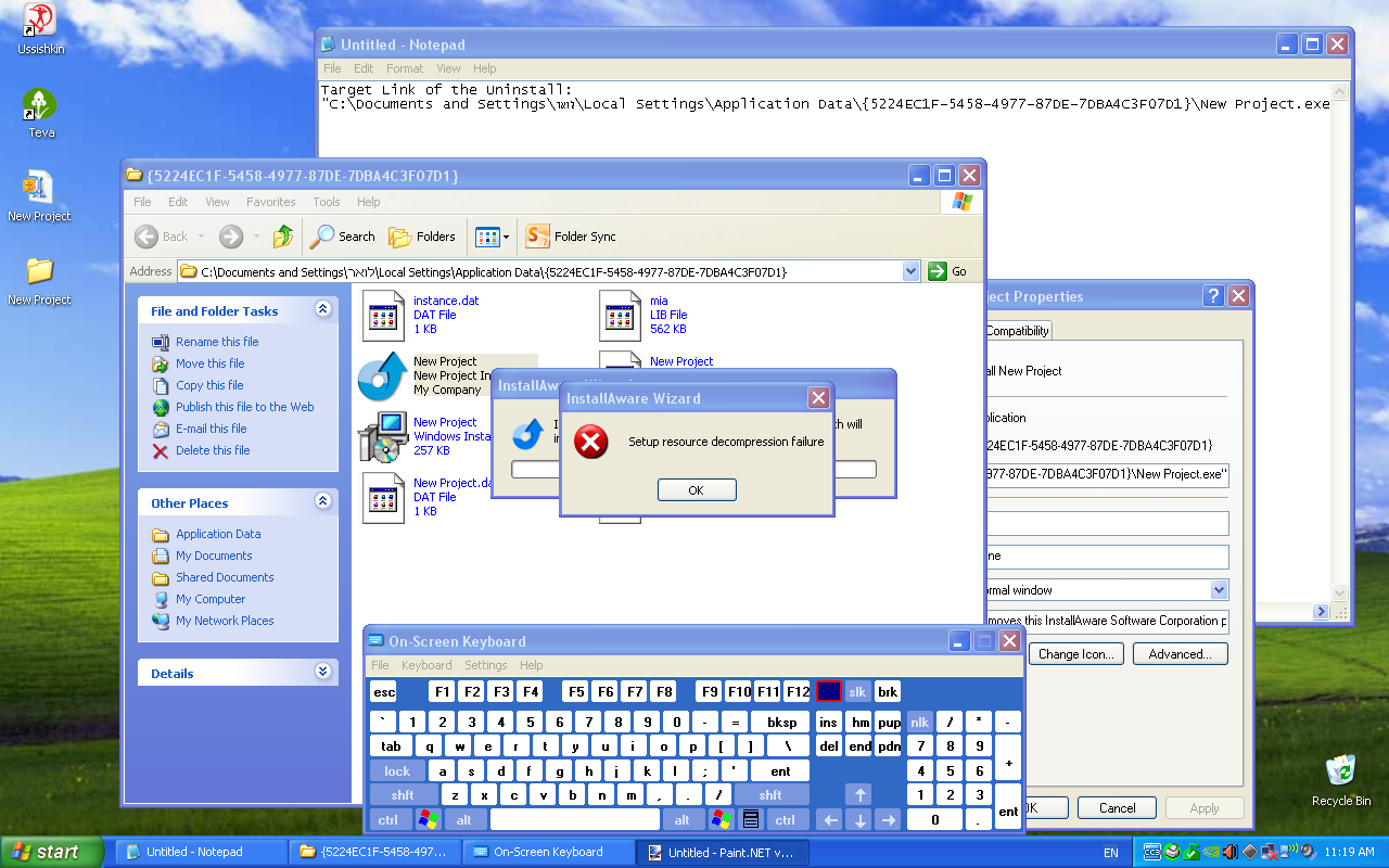

Sorry for the delay, I was travelling and couldn't get to this task!
One settings I have is in the Language settings, choose Hebrew for the non unicode.
To answer your questions:
1. See the attached screenshots
2. Target Link of the Uninstall:
"C:\Documents and Settings\לואר\Local Settings\Application Data\{5224EC1F-5458-4977-87DE-7DBA4C3F07D1}\New Project.exe"
If you look at the Updates errors, you can see that Michael and mine are almost identical. It is the same for the uninstall ones.
Benjamin

- This screen shows both the error of my installer and the one of MichaelNeshbit
- Update New Project error screen.png (627.9 KiB) Viewed 48263 times
- This file is the error of the uninstall link
- Uninstall New Project error screen.png (430.79 KiB) Viewed 48263 times

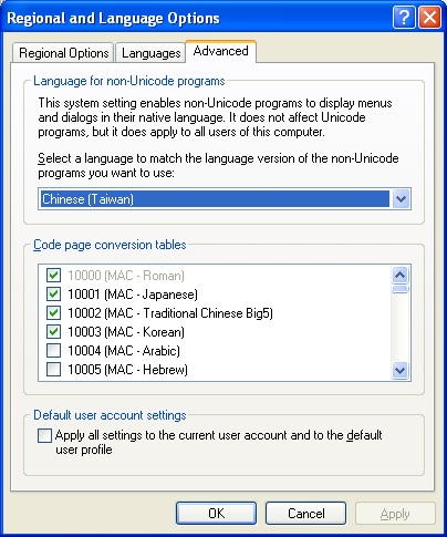

Here's what I'm seeing when I try to run a basic setup with only a line added to display $EXEDIR$ compared to the folder path displayed in explorer:
I've also tried playing around with language/locale settings also:
It could be helpful to know what your TMP/TEMP environment variables are set to.
Also, if you put a messagebox as the first line of code, will the messagebox appear before the error?

After some more investigation, I can say now almost for sure that the problem comes from Right-to-left languages (hebrew and arabic mainly)
Here is what I can say about my testing:
1st test:
1. I set the language for non-unicide to Hebrew (you need first to enable the "complexe script language" on the second tab of the languages and regional setting)
2. Install the exe for the current user only
3. try to click on the update or uninstall shotcut in start menu --> this should raise the errors
2nd test (reverse step 1 and 2):
1. Install the exe when the language for non-unicide is Hebrew
2. Change language for non unicode to English
3. try to click on the update or uninstall shotcut in start me: update does not work and uninstall raise an error (invalid command line)
I don't know the inside of MSI and windows enough to draw conclusions but it seems to me that this is related to the way $exedir$ is defined. It should be defines in a way that is "non-unicode language" agnostic so that changing this param will not affect the way the installer works
