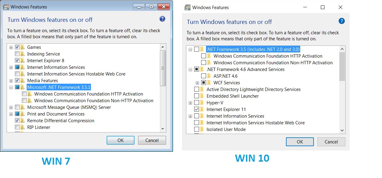

How can I install .Net 3.5 using InstallAware on a Win10 OS ?
Postby Steve » Fri Jul 29, 2016 3:18 pm
Sounds simple, but it is not!
This is a significant problem for anyone wanting to install SQL 2014 in their InstallAware installation package on a Win10 OS, because .Net 3.5 is a required SQL prerequisite. Prior versions of SQL included .Net 3.5 within the SQL installer package (so the problem did not exist prior to SQL 2014), however MS in their infinite wisdom, no longer include .net 3.5 in the SQL installation package... Yet SQL requires it!!!
How's that for the ultimate in Microsoft stupidity...
The problem when using InstallAware to install MS SQL 2014 in my installation package is that Windows 10 does not install .Net 3.5 automatically. THE ONLY WAY TO INSTALL .NET 3.5 on WIN10 is to go to:
> "Control Panel> Programs and Features>Turn Windows Features on or off"
> From there you must enable the .Net 3.5 checkbox, then click 'Ok'
> Windows will then connect to the Internet ( via Windows Update Service) and download and install the .net 3.5 components.
Quite obviously this is stupid! It means that my InstallAware installation package will fail during the SQL 2014 installation, and the user will have to figure out how to install .Net 3.5 (and undocumented convoluted process) and then rerun my InstallAware installation package again.
I figured that the simple way to solve this would be to install the .Net 3.5 runtime, but Noooooo :x , Windows 10 will throw an error and prevent the .net runtime (included with InstallAware) from installing. Win 10 forces you to use 'Turn Windows Features on or off' in order to install .net 3.5.

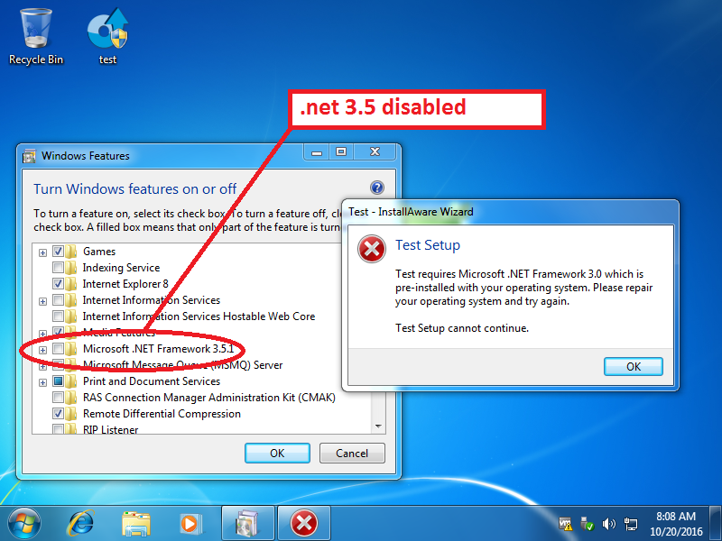

Thanks for your last reply. I have spent countless hours trying to get this to work and quite simply, it does not.
Currently I am using X5. I have even built a simple little IA test project that is supposed to install/enable .Net 3.5.1 on a WIn7 x32 machine, according to your instructions (I am referring to your link to the post above)...
However, it does not enable .Net3.5.1 !
I have tried an MSI install and a Native Engine install and simply put, .Net 3.5.1 will not become enabled on a Win7 (same with Win 8 and Win10) OS.
The installation starts and ends 'apparently' successfully, but absolutely none of .Net 3.5.1 is enabled.
I built this test install in about 2 minutes. This is how simple my IA installer test package is:
1) Created a brand new project using the 'Native Engine' template
2) Enabled Application Runtime "Microsoft .Net Framework 3.5 with Service Pack 1" .
(this in turn automatically enables the following Application Runtimes):
3) I did not modify, customise or even look at the IA scripting
4) Built the installation package using both Web Deploy and CD/DVD modes.
5) Ran the finished installation package on a Win7 x32 OS.
No matter which installation package (Web Deploy or CD/DVD) I use, nothing gets installed (absolutely none of the runtimes) and .Net3.5.1 does not get enabled.
My test install could not be any simpler in terms of being striped down... So obviously there is something I am doing wrong or perhaps IAX4 to X5 has a problem?

by default with any Win 7 OS installation .Net 3.5 is already pre-installed and enabled.
So, how did you check that .Net 3.5 doesn't get enabled or better, that .Net 3.5 is not enabled already?
The reason of my question it's due the fact that when Net 3.5 is not already enabled with a Win 7 target, your test installer should display the following message.
Steve

I didn't want to introduce too many confusing variables into the conversation initially, so I intentionally did not talk about the reason that I created this IA Test installation package...
Specifically, the problem that I was having with my 'real' project was that I was attempting to install SQL 2014 via the 'Microsoft SQL Server Express 2014 SP2 (x86 and x64 WOW)' application runtime. However SQL Express 2014 would not install. The runtime's progress bar would just run/cycle forever without the install ever actually progressing. I eventually determined that the reason for this was that SQL was reporting that .Net3.5 is not installed on my OS. I encountered this same problem on both WIn10, WIn 7 and WIn8. How's that for the height of Microsoft stupidity... MS SQL requires .Net 3.5 but does not include it in their installations package and they also don't install it on their operating systems! They also will not allow it to be installed using an Application Runtime because the OS thinks that it is 'pseudo installed' as an OS component already.
From Microsoft: "Windows 7 (all editions) includes the .NET Framework 3.5.1 as an OS component. " This means you will get the .NET Framework 2.0 SP2, 3.0 SP2 and 3.5 SP1 plus a few post 3.5 SP1 bug fixes. The .Net Framework 3.5.1 can only be added or removed via the 'Programs and Features' -> "Turn Windows features on or off" UI.
Anyway, when I checked deeper into this I discovered that Microsoft essentially 'pseudo' installs .Net 3.5 on each of those operating systems. What I mean by 'pseudo installs' is that MS put a placeholder in the "Turn Windows features on or off" UI so that .Net 3.5 shows up in the 'Windows Features' list of available installed features (ie, like the one that you included in your screen capture) even thought it is not really installed. However, if you expand the .Net 3.5 feature, you will see that none of the .Net 3.5 components are actually installed on the OS. Following are screen captures of both Win 7 and Win 10 'Windows Feature' lists. You will see that the checkbox is 'blue' in the Win 7 Features list which 'technically' means that some features are installed. HOWEVER, if you expand the checkbox you can then see that NO Net 3.5 features are actually installed.
So, in answer to your question "how did you check that .Net 3.5 doesn't get enabled", I did two things...
1) looked at the 'WIndows Features' list to see if the .Net3.5 components had been installed and as you can see above, it was not.
2) I installed MS SQL 2014 Express (downloaded directly from MS... not the IA runtime), which will not install because it states that .Net 3.5 is missing from the OS.
I believe that I need to point out what I believe to be an error in your comment that Win7 has .Net 3.5 installed. It is not included as a fully installed framework in Win 7. There is absolutely no doubt that .Net 3.5 is not installed on my target machines and also that it is not being installed using the test project.

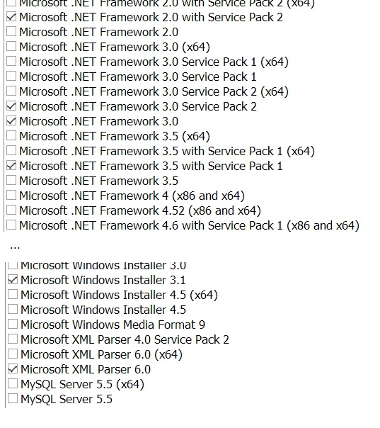

first of all, the project you posted includes the application runtimes for; net2sp1, net35 and net3sp1, which are not required and even these don't get included by IA when selecting Net35sp2.
Second, the two .Net 3.5 components visible when expanding when expanding the .Net 3.5 feature, are just an optional selection. So to have the .Net 3.5 feature installed and enabled, it's just necessary to have the checkbox filled. I am totally sure of this.

First off, what you have just written in patently incorrect. I am using IA X5 and if I enable Application Runtime "Microsoft .Net Framework 3.5 with Service Pack 1" (as I showed in my included screen captures), InstallAware automatically enables:
1) Microsoft .Net Framework 2.0 with Service Pack 2
2) Microsoft .Net Framework 3.0 with Service Pack 2
3) Microsoft .Net Framework 3.0
If these runtimes are not needed, then why does InstallAware automatically enable them?? I have to assume that if your programmers wrote the code to specifically enable these three additional runtimes, then they did it for a reason and not just in order to intentionally make InstallAware difficult and frustrating to use! :lol:

for what concerns "Microsoft .Net Framework 3.5 with SP1" selection in IA X5, this will automatically include the following RTMs dependency;
- Microsoft Windows Installer 3.1
- Microsoft .NET Framework 2.0 with Service Pack 2
- Microsoft XML Parser 6.0
- Microsoft .NET Framework 3.0
- Microsoft .NET Framework 3.0 Service Pack 2
These are All correct and required in order to complete "Microsoft .Net Framework 3.5 with SP1" RTM installation correctly.
With the project you posted I found that this included also; " Microsoft .NET Framework 2.0 sp1, Microsoft .NET Framework 35 and Microsoft .NET Framework 3.0 sp1" ... IA doesn't include these RTMs when enabling "Microsoft .Net Framework 3.5 with SP1" and are NOT REQUIRED AT ALL.
