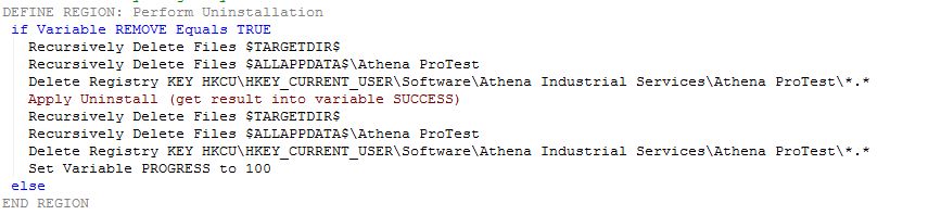

If this is quicker, the reason i am trying to debug is that on uninstall not all the created folders are being deleted. I use the following code. Tried before and after the Apply Uninstall command but no effect. I can't even find where the REMOVE variable is set in the MSI code.
Cheers
- uninst.JPG (41.93 KiB) Viewed 51150 times

It makes total sense and i bet I know why mine fails to do the uninstall. I modified my installer to not advertise (i think thats what its called), and not show the majority of windows upon install. I guess I need to re-enable the dialog which prompts the user for the options you mentioned. I will try that this morning and get back to you.
On a side note, did you have any ideas why my files do not get deleted upon uninstall as i mentioned in the previous post and screenshot? I think once i can debug a may get some error messages but if not it will be my next question. I can start a new post if you do not want cross-question postings to occur.

It can really be anything - perhaps you got the file names wrong, or maybe the files are in use and therefore cannot be removed. Please try to debug the uninstall process, it will probably be a lot more helpful than my guesses
