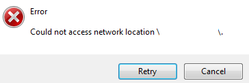

I chosen REPAIR out of (REPAIR/UNISTALL) on maintenance screen. And i am getting an error while REPAIR in progress.
ERROR: Could not access network location \$TITLE$\
Note : Title is your product name
and This error is coming on following line of script:
Apply Install (get result into variable SUCCESS)
Rapair of insttaltion is not working
- Error Screen shot
- Capture.PNG (6.98 KiB) Viewed 6757 times

Re: Rapair of insttaltion is not working
This generally happens when one of the paths used by your installation script commands, such as Install Files, is ending up with a partially formed path - thus the MSI service is unable to properly resolve the path. This could happen only on a repair run because of errors in your script, and not expose on a first time install. But the problem is most probably in your script and can be fixed by verifying all runtime paths, even during a repair process, are well formed - easy to fix using the debugger.
thanks for reply.
As you explained issue might be with Install Files path.
I found the issue with the same. when installation in the Repair mode.
the system variable $APPDATADIRALL$ is not setting properly.
As i noticed Value of ($APPDATADIRALL$) variable
In Installation Mode : "C:\ProgramData"
In Repair Mode : "" Blank
I am not sure How to set that variable in the Repair mode. since it was system variable.
I also tried to set this variable like this:
Get Common Folder Location System->Application Data Directory into APPDATADIRALL
Can you please tell me how can i get this done.

- Posts: 3452
This isn't really a system variable actually - its instead a variable that is defined in your script using the Get Folder Location command.
You can make the variable a persistent variable by first initializing it using Set Variable to any value - this will persist the value across runs.
Or, you can just make sure the place you define it currently also executes during maintenance mode.
I am surprised this is not already the case, where/how are you currently defining this variable?
I have this same issue. From what I can tell this is not working during a re-install on Windows 7. Is this a known issue?
Get Common Folder Location System->Application Data Directory into PROGRAMDATA
Please advise.
Please advise.
I worked around this with this code, I am going to try to remove it with InstallAware 9 R2 and see if it is fixed.
if Variable PROGRAMDATA Equals
Set Variable PROGRAMDATA to
Get Common Folder Location System->Application Data Directory into PROGRAMDATA2
Set Persistent Variable PROGRAMDATA to $PROGRAMDATA2$
end
