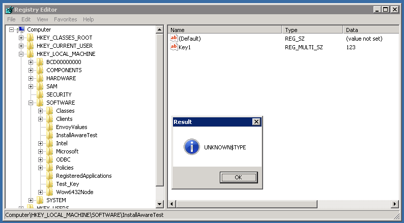

Please run the attached .reg file (inside the zip).
Then, run the following script from InstallAware:
~InstallAware Clipboard Data~
~MessageBox~
~{479BD449-3971-4643-B00B-43D7DCA03B9F}~
~Result~
~$REG$~
~0~
~1~
~Check Registry~
~{B1854FE4-8D0B-4F4A-9069-046B62BE95E1}~
~REG~
~2~
~Software\InstallAwareTest~
~Key1~
~Set 64 Bit Mode~
~{6003BB57-EC45-4991-A00E-7F445732C754}~
~FALSE~
~FALSE~
~TRUE~
Let me know what the message box shows please.
test.zip
(228 Bytes) Downloaded 397 times
Chris_DMG
Posts: 30
Joined: Tue Nov 02, 2010 8:09 am
Re: Reading Reg_Multi_Sz values in 64 bit registry
Post by Chris_DMG »
The result is still displayed as UNKNOWN$TYPE
