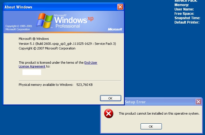

Hi, We successfully compiled our setup, and when we tried to test it on XP PC (SP3) we get the following message "This product cannot be installed on this operative system".

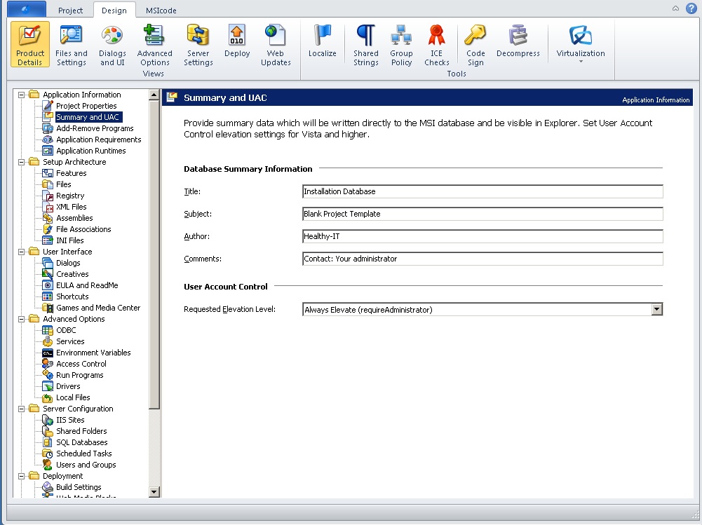

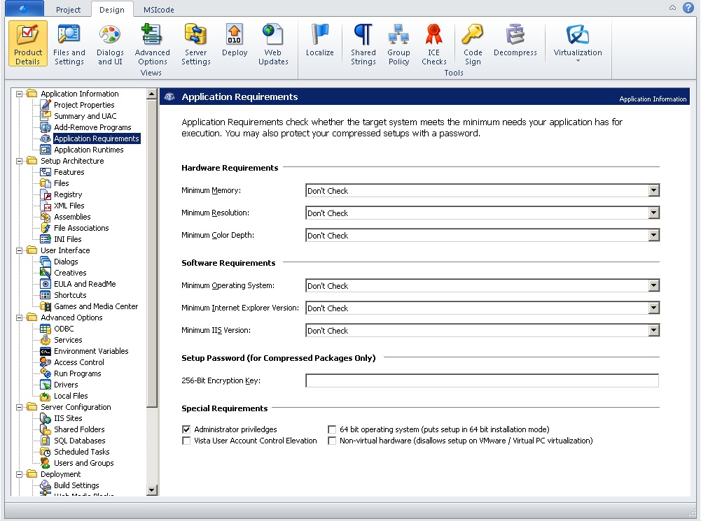

in [Application requirements], We didn't select any requirement except to have "administrator privileges", and in [Summary and UAC], we set the "Requested Elevation Level" to "Always Elevate".
Could you please advise what could be wrong?

- error.jpg (66.81 KiB) Viewed 12193 times

Hi, Thank you for your reply. I did double checked back, and i did removed all the checks. Still couldn't install on XP
- 2.jpg (223.5 KiB) Viewed 12183 times
- 1.jpg (193.33 KiB) Viewed 12183 times
