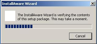

I have built my project as Compressed Single Self-Installing EXE [as per our requirement].
But whenever we click on installation package, one initializing screen appears saying "The InstallAware Wizard is verifying the contents of this setup package. This may take a moment." as per following attachment.
Can we remove this screen from start?
Thanks..
Remove InstallAware Wizard initialization screen

Unfortunately, you can not remove this dialog unless you do not use a silent install from command line.
ES: <setup.exe /s>

Can we update the caption and content of this dialog?

Re: Remove InstallAware Wizard initialization screen
its an installer shared string and can be edited by running the mTranslator.exe tool.
Starting from InstallAware 11 you can also use Branding Removal option, for this please refer to this topic:
http://www.installaware.com/forums/view ... f=2&t=6769

Hi Francesco.
The branding removal function only removes the InstallAware wizard from dialog's caption.
Can you please explain with some more detail that how I can update the initialization dialog with the help of mTranslator.exe tool?
just replace as you watn the shared string for the language that you are using.
From the Design view, select the "Shared String" button. This will start the "mTranslator.exe tool".
Once active, select your desired language and replace the strings that you want to change.
Close the tool and rebuild your project.
That's it.
Hi Francesco,
Many many thanks...
This is what I wanted.
Thanks again...
