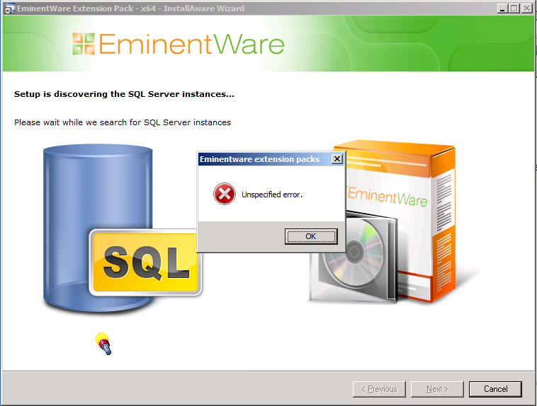

The program executes however the RunProgram call seems to randomly display a MessageBox
with an error displayed as....
'The operation returned because the timeout period expired.'
OR
this error...
Once this error messagebox is dismissed, the next page is displayed and proceeds as usual.
OR
this error...

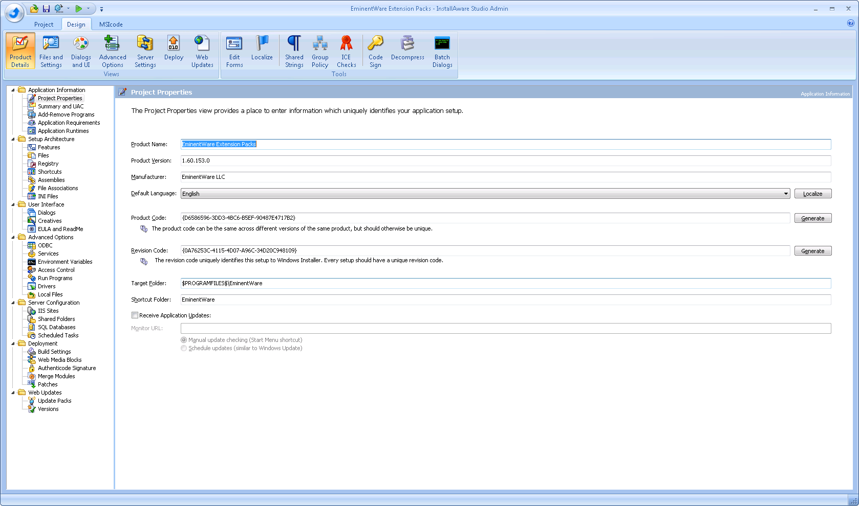

Secondly, you are assuming we dont change the title of the install at runtime, which we do.
Here is snapshot of the project info...
This title, other than a case change of the text, matches the MessageBox title window as you can see.
So, saying this isnt being generated from IA doesnt seem correct.

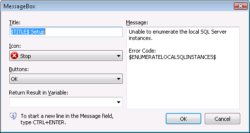

So, from the code, you can see that we DO trap the return value/message and we DO display a message box if there was a failure.
Here is the message box property dialog...
So, as you can see, that message box would NEVER display the message you are seeing, but rather something quite different.

Hi Michael,
couple of clarifications...
First, this project was migrated from IA7, not IA9.
Second, the process is always being properly executed by the Run Program and hasn't ever returned an error, simply success.
My point in telling you about the process not being present (in the active process list) when the MessageBox is actively displayed rules out any possibility that the CLI app is displaying the MessageBox.
Remember, the REAL problem here is the IA setup is displaying an MessageBox indicating there was a problem.
Sometimes the error in the MessageBox is...
'The operation returned because the timeout period expired'
sometimes the error in the MessageBox is...
"Unspecified error'
Upon clicking the OK button to this Messagebox, the setup continues without issue.
So, you are telling me there is NOT logging we can enable to get more information? Is that correct?
You are telling me there are no tools that you have to attach to the IS setup to get more information?
"Unspecified error'

Hi Michael,
We have a Hyper-V virtual machine snapshotted with the error reproduced.
We can also zip up all the project files as well and post them.
We are looking at how to get it up on our site so you can get access.
Also of note, I also used ProcessExplorer to show you the callstack of the IA produced EXE.
Based on the call stack in the main thread of the IA produced setup exe, the MessageBox is definitely coming from it as you can see below.
