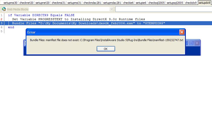

Ok I downloaded and ran the Update Pack which was also helpful because my application requires CrystalRepots for .NET 2.0...
When I try the bundle files plug-in I get an error about a manifest file?
I attached a screenshot showing how I am implementing the bundle files and the resulting error.
Thanks for your patience.
Bob
Posts: 3452
Postby MichaelNesmith » Mon Mar 13, 2006 4:49 pm
That's an interesting error! Maybe the plug-in author can help.
Also, we have an update (5.3) which ships tomorrow. You may want to wait until then, the update includes a File Bag plug-in, which is sort of an improved Bundle Files.
