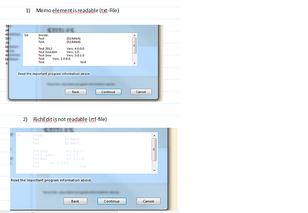

And I have tried with richedit-element a build, but I have optical problems to read the readmefile, because it is unreadable...
I tried to set the colors, but that has no effects. Is it a problem with theme glass?
But look self:
1) is memo field which works with txt
2) is richedit field which works with rtf
and I put a small projekt inside to have a look
regards
My Sample Project_Readme.zip
Problems with theme glass and readme and richedit
(606.86 KiB) Downloaded 413 times
Re: readme- txt rtf problem
Postby FrancescoT » Thu Dec 27, 2012 8:41 am
Dear Rulan,
As I said with my first reply;
The Official dialog theme uses glass effect as well, but limited to the top dialog area (Only), in order to improve the render capability of the RichEdit control.
Unfortunately, there are text readability problems with RichEdit control if used with glass effect not applied to a limited dialog area.
Postby FrancescoT » Thu Dec 27, 2012 11:22 am
Dear Rulan,
I try to explain it once again.
The RichEdit control can be used with glass effetcs, but having care to apply the effect to a limited dialog area.
This is not an InstallAware limitation but depend on how the control paints its client area.
Now I have to find a new theme for all our setups we did before? This means much efforts until now for nothing?
No, because you can easly modify your glass effect apparence to be applied to a limited dialog area. Please have a look at the attached sample project.
Why You have "glass" in your basic theme-selection?
In fact, the FULL glass effect dialog theme doesn't use the RichEdit control but the Text Memo instead ( ... that correctly displays a text file as I verified previously ... see my reply).
Is there no workaround?
Have a look at my project.
Readme&license.rar
(1.36 MiB) Downloaded 428 times
