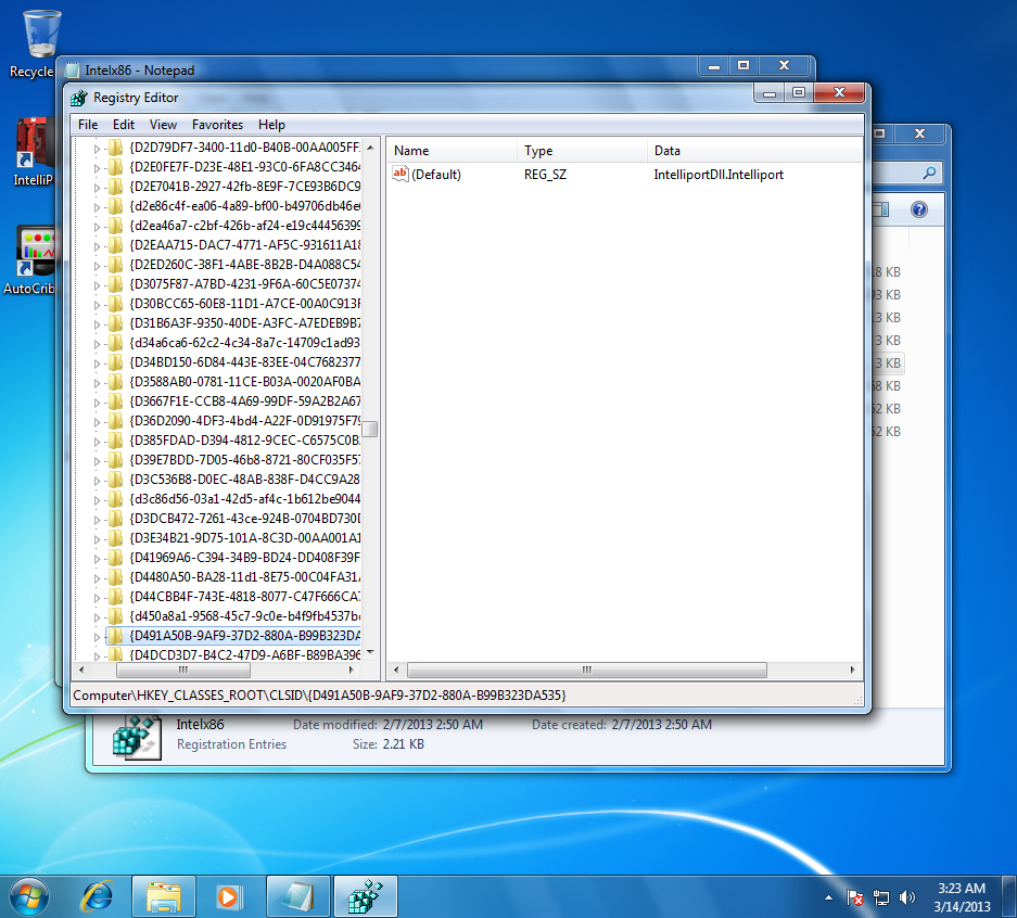

Re: Batch file does not run properly
I just verified your package and it worked fine with my verification.
I tested the package using WIN 7 x86, with Net 2.0 & 3.5 runtimes installed.
As you can see by the following screen-shots;
1# the CMD window of the executed BAT file once the installation has been completed.
2#... and also the registry entries are correctly added to the target registry.
Just a note; use the "RegAsm.exe" already available on target OS insted of adding it to your installation files.
The tool is available on target system under the Net framwork version folder.
For example for Net 2.0 is; C:\WINDOWS\Microsoft.NET\Framework\v2.0.50727\RegAsm.exe
