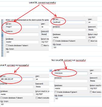

IA15, SQLSERVER 2008 R2
We want to use sql scripting from setup...
But we have great problems to get a connection to SQL-Server:
1) we scanned with MS SQL Instances an found differnt Instances, inclusive our own PC.
2) We can connect to local db of local Workstation with the scanned name -- successfull :D
3) We connect to local db of local workstation with "localhost" --- successfull :D
4) We connect to local DB of Workstation with TCPIP --- Not successfull :(
5) We connect to a not local Db on a different PC with scanned name or TCPIP -- not successfull :(
We only can get a connection to local db.
firewalls are down.
Protocols for mssqlserver: Named pipes and TCP/IP activated.
SQL Server Browser and Agent are running.
what is going wrong? what else can we test?
Connection to the foreign dbs with managment studio are successfull.
regards

By your screenshot, it not easy to read the parameters used with command, due the poor resolution image you posted.

Hello Francesco,
we experienced... and tested...
-We use a PCs, where the connection work -we use mssql with a "go" command and read out the variable..
1) In Servername we type "IP" of the sqlserver and we get "success" for the connection! :D
on netstat -an we could see that our machine listen to port 1433.. every thing is fine...
2) But now!!!
Same maschine same settings!!!
We changed to combination "ServerName,1433" = "sameIP,1433", we get "Database error" for the connection...
on netstat-an we could not (!) see that our machine is listening to any port...
Do we something wrong using the parameters HOSTNAME,PORT?????
we are not able to use port-parameters with the syntax from above.
regards
