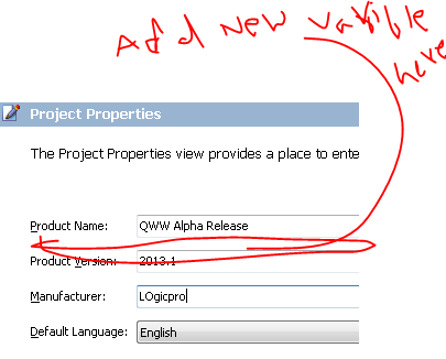

I need to declare a global variable that should appear in GUI while creating build.
Same as:
Predefined variable Product name = $Title$
Currently I declare $Title$ for our Product name.
But I need to append a variable called Dailybuild or Weekly build after the $Title$
For that I need a separate variable like $new_variable$ = dailybuild(02/03/2013).
Problem is i want the variable to be present in GUI as how the Product name or product version is shown in InstallAware.
Is it possible to add a new variable in GUI below Product version?

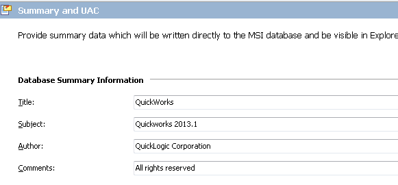

Or I need information on how to access the variable present in Data Summary information:
So that I will use that variable in my script.
For eg : Subject = dailybuild(02/03/2013) . But i do not know how can i access the subject variable !!!

Nope, it does not solve my problem.
We have something like $TITLE$ $VERSION$
But I need like this
$TITLE$ Dailybuild (02/03/2013) $VERSION$
This Dailybuild (02/03/2013) should be assigned to some variable.
This can be changed same as we change version.

Well I do understand that we can declare a variable and then assign a value.
But I want to use the existing values of Project properties.
Title :
Subject :
Author:
Comments:
So let me know how can I use Subect value in my code? Is subject assigned to some global variable or any variable?
Title :
Subject :
Author:
Comments:
Re: Add a variable
All the available pre-defined variables and pre-defined compiler variables are listed and described with InstalAware documentation (just press F1 from IA IDE and search for; "pre-defined variables" or "pre-defined compiler variables").
Currently, it is not available an already defined variable for "SUBJECT" to use.
But you can define a custom compiler variable for that and then, you can use its dereference with the project settings.
"The syntax for dereferencing a compiler variable in InstallAware is enclosing the variable name between pound signs. For instance, if the variable is called MYCOMPVAR, dereference the variable using #MYCOMPVAR#. You may freely combine multiple dereferenced compiler variables in your string literals."
