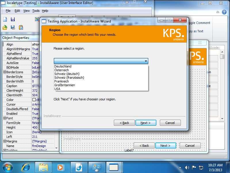

I have updated to IA16 and now I cannot edit a combo-box in my dialog. I think it is because of some characters in the item list, look attached picture. What can I do, do I have to built the dialog completely new?
EDIT: this is what was insert as items:
Deutschland
Österreich
Schweiz (deutsch)
Schweiz (französisch)
Frankreich
Großbritannien
USA

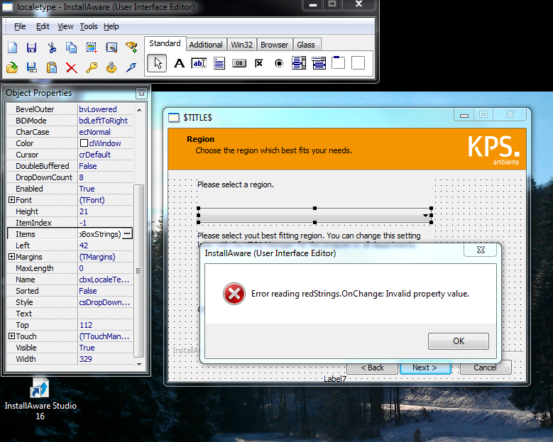

Problem in Dialog Editor after upgrading to IA16
- Error after klicking the item edit button in the dialog editor.
- ia16_dialog_item.PNG (350.17 KiB) Viewed 10997 times

Re: Problem in Dialog Editor after upgrading to IA16
Yes I can also "run" the dialog. But have you tried to edit the items of the combo box!?
You will get the error...what to do now.
