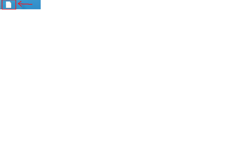

WhenI pin to taskbar on windows 7 everything works great...
After upgrading which uninstall and installs i get a blank icon in taskbar which works fine and open my program.
This icon changes correctly after some refrashes like logging of and on or running program als right click on icon shows the righr icon.
how can i make it happen without refrashing the desktop?
Thank Erez
attached is the empty taskbar icon
Pin to taskbar on win 7

- empty taskbar icon
- icon13.7.png (16.74 KiB) Viewed 6285 times

Re: Pin to taskbar on win 7
It may be possible to write an application to remove the pin. The best place to place it would be after the (Un)Install MSI Setup plugin call (Install/Remove MSI Package).
