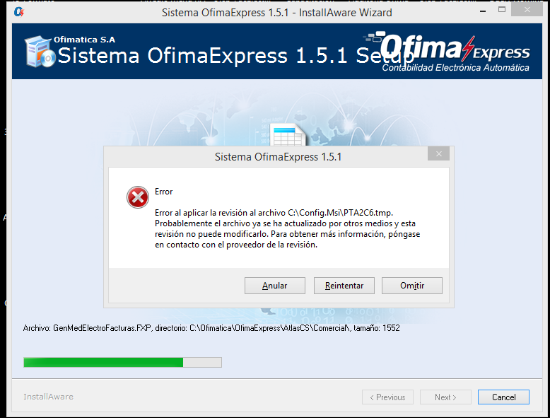

When installing the upgrade package to generate the error according to image
Analyzing the error
1. I have a file with the name "GenMedElectroFacturas.fxp" in a folder called "COMMERCIAL"
2. Also I have another file named "GenMedElectroNominaPLUS.fxp" in a folder called "NOMINAPLUS"
3. Both files need to be updated
4. My theory is that start with the same name "GenMedElectro" and I keep updating the file first.
5. I checked and change the "GenMedElectroNominaPLUS.fxp" file "NominaPLUSGenMedElectro.FXP" and if WORKED CORRECTLY.
Question?
It is a reported error or some bug that does not support InstallAware same name at the beginning ???
or that causes this error may be
Thank you very much for your prompt response.

- error Actualizando Ofima Express.png (105.26 KiB) Viewed 2864 times

Dear HERNAN,
in all honesty, it's not totally clear to me the error message you are receiving at patch Runtime
Anyway, I suggest you to have a look at steps described with the following link;
http://www.installaware.com/forum/viewtopic.php?f=2&t=9635&p=35582#p35582
(see my reply dated "Thu Aug 01, 2013 11:53 am " about " Power Tweaks").
