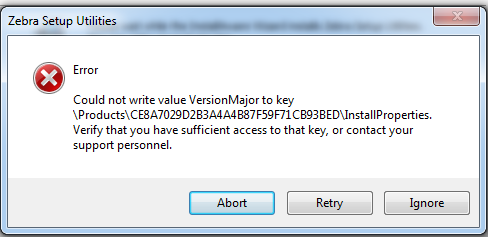

I am building an IA 15 installer within FinalBuilder (also tried the miabuild.exe with the same effect) and am having problems.
When the previous version of the program is installed the new installer will detect and start the uninstallation process.
Then a dialog pops up and shows an error that will end the installation:

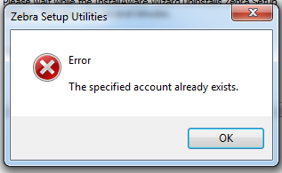

Next the new installer is started to install the application and this error pops up:
This also terminates the install and the installation is not complete.
If I run the IA compiler within the IA GUI the installer works fine for uninstalling the old version and installing the new version.
What is happening and how can I overcome this issue?

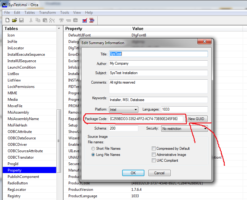

Re: Installer error when build within FinalBuilder or comman
Hi Francesco,
I have tried compiling the project with miabuild on the command line and used the following command:
D:\Jenkins\Workspace\EpDriver\InstallAware>miabuild treefrog.mpr /r ZSU_VERSION=1.1.9.1187 VERSION_NAME=v1-1-9-1187 SIGNING_DIR=D:\Jenkins\Workspace\CodeSign SOURCEROOT=D:\Jenkins\Workspace\EpDriver
Interestingly when comparing this build with the build that was build with the GUI it did un-install the previous and install correctly the new but the UpgradeCode in the Property looking at the MSI with Orca is the same. I can't find the Revision Code that is set in the project. The UpgradeCode in the Orca Property table is the same in both installations.
Can you shed some light on this?
Best regards,
Best regards,
Manfred Wilner
Dear Manfred,
of course the "UpgradeCode" will be identical but not the "Revision Code" (if the relative option is checked).

As I am still struggling with my original issue that of the installer build with FinalBuilder causing this error would you have any idea why compiling with the IA GUI the installer works but calling the miabuild from FinalBuilder will cause this strange access error that seems to pop up out of the blue. Especially when you go into the registry and check this specific key there are already entries from the installer in it.
It is clearly not a problem with the IA script as it will produce a proper installer but has something to do with the command line or how FB is calling IA.
Best regards,
Best regards,
Manfred Wilner
Dear Manfred,
unfortunately, I suppose it's due the way FinalBuilder uses ("internally") to call an external process.
