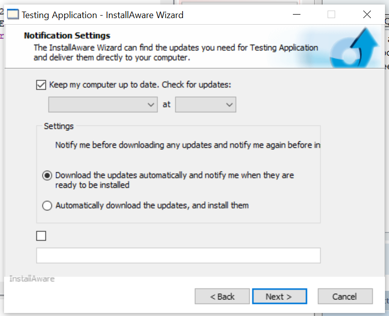

Postby ntroncoso » Tue Apr 14, 2020 1:17 pm
I need to add an additional field to the update_setup_schedule dialog. I added this to the bottom of the dialog, but it didn't have room. So, increased the height of the dialog. When running the installer, it is showing white at the bottom of the dialog. See the image below. I attempted changing both the ClientHeight and the normal Height properties, but they both do the same thing. I tried messing with the Color, but it still shows the white at the bottom.
Thanks in advance!

Postby FrancescoT » Wed Apr 15, 2020 1:49 pm
The white area at bottom of the dialog, it's controlled by the VistaGlass Control.
You can modify such size from Dialog control. Load the dialog, select the "VistaGlass Control", and then set as you prefer the value of the "GlassBottom" property.

Postby ntroncoso » Mon Apr 20, 2020 3:19 pm
Thank you very much. That solved my issue
