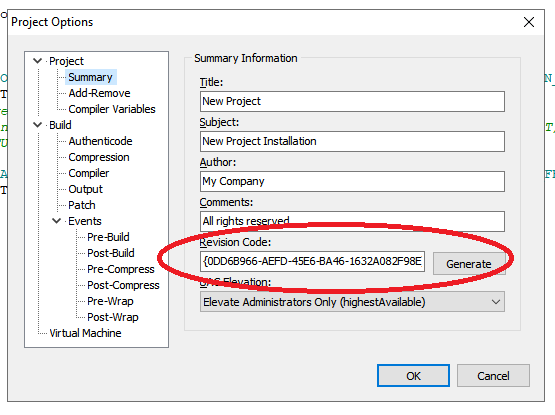

Things are even simpler in IA.
InstallAware uses the REVISIONCODE to identify each build of a setup package.
•Press SHIFT+CTRL+F11.
So by default implementation, the REVISIONCODE gets re-generated automatically on each build. This has the effect that at setup runtime, each build gets then detect as new full product update. Of course, you may turn OFF the automatic re-generation of the REVISIONCODE when necessary (From the same Option Dialog, select Build node -> Output, for the "Change revision code automatically upon rebuild" option).
That said in your case, to produce a new full update you simply need to generate a new build of your setup. At setup runtime, this will full replace any existing version of the same product which is found installed.
In addition, I may suggest you to have a look at the following thread for other useful information about the matter.
https://www.installaware.com/forums/viewtopic.php?f=2&t=10734
Hope this helps you
Enter a unique identifier for your setup here. Click the Generate button to create a new unique identifier if you are not sure that the displayed identifier is unique. The Revision Code must be unique for each different setup. Unless each setup you build has a unique code, they will appear to be the same installation package to Windows Installer, even when they are not. Even slightly different versions of your setup must have a unique revision code. You can have InstallAware automatically update this code every time you rebuild your setup project using the Build Settings window.
Hope this helps you
