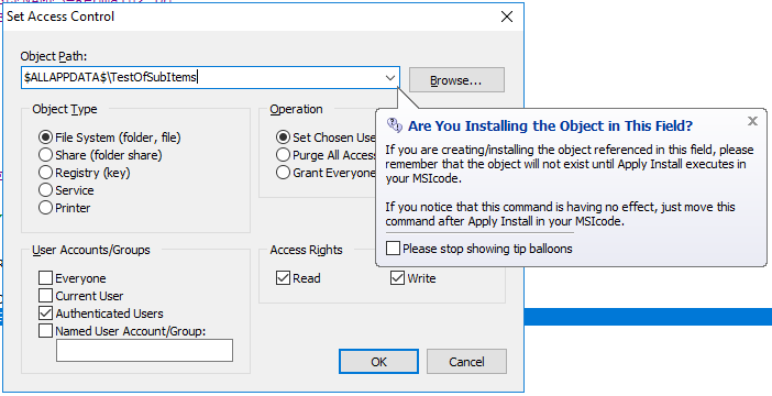

We are using InstallAware Admin X11. I am struggling to set permissions to subdirectories and files in InstallAware.
I am trying to ensure that a folder, and all files and subfolders within that folder, will have Read/Write for Authenticated Users. My MSICode for this is just after Apply Install, as specified in the hint.
What is the correct approach? I believe I have selected the appropriate options, ref included screenshot.
Thank you.

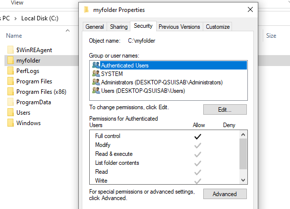

I did a simple test using the code below, and permissions were applied correctly.
Create Folder c:\myfolder
Set Read Write Permissions on File System Object "c:\myfolder" for Authenticated Users
The only difference here with my test, it's that I had to use the latest IA version.
