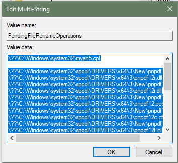

I am having issues reading a REG_MULTI_SZ string from the registry. I need to test this string for certain values.
The issue seems to be if there is an empty string in the middle of the list of strings, all other strings after that get ignored. I am not in control of the contents of this string, I just need to test.

Re: Problem with REG_MULTI_SZ Strings
This looked promising but still did not allow me to get at the strings after the blank line.
My message box displayed the first line, once at the outside reading the key, and once in the for each loop, then left.

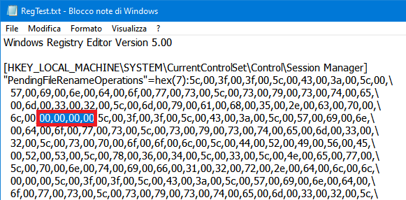

- Posts: 124
- Joined: Mon Oct 22, 2012 2:14 pm
I do have a saved .reg as it made it easier to test myself.
I've attached RegTest.zip, which contains RegTest.txt. Just change the extension from .txt to .reg.
It contains a multi_sz key that exhibits the issue. The contents of this key were created while uninstalling/upgrading/installing using our product setups created with InstallAware.
You may want to change the path to the key in the .reg for your testing as the actual key I need to use and have given here is the PendingFileRenameOperations key that gets used on reboot.
- RegTest.zip
- (1.09 KiB) Downloaded 834 times
Ok, I'll let you know.
Dear Shery,
unfortunately it exists a problem with the multi-string data.
The pattern "00,00,00,00" indicates the termination of a multi string sequence.
So there isn't any empty string in your multi string sequence, but instead the multi-string sequence terminates just after the first string.
