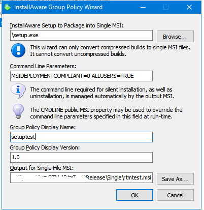

Or by injecting command line parameters into the MSI using the "Group Policy Wizard" tool (included with IA - This wizard creates a single MSI file that may be used in corporate deployment scenarios).
For what concerns the the "UAC Compliant" setting, this cannot be changed at project level (this due the fact that such setting is MANDATORY from Windows Vista and higher versions). At any rate, doing some researches, the "UAC Compliant" setting should be controlled by the "MSIDEPLOYMENTCOMPLIANT" property.
https://docs.microsoft.com/en-us/windows/win32/msi/msideploymentcompliant
You may try with passing "MSIDEPLOYMENTCOMPLIANT=0" from command line, or you may inject it through the "Group Policy Wizard" tool.

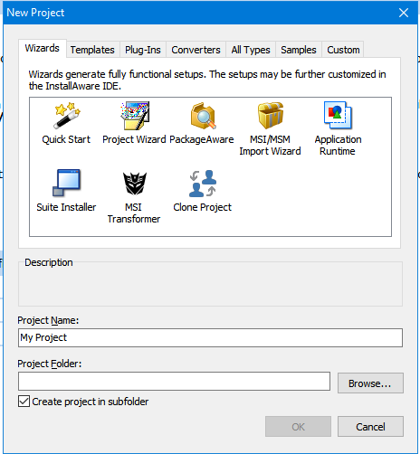

I've been curious if we've used the wrong project template to support the installation on Intune also. I had created this new project by copying from an older project and now I'm wondering if we should start from scratch. That is another reason I posed in the forum to see if anyone else has experience in understanding what is needed for Intune.

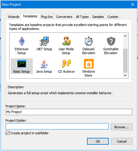

I'm not sure how you cloned your project. If you are using x13 or higher versions, the currently active project can be easily cloned using the integrated "Clone Project Wizard" tool.
Alternatively if you prefer to create a new project from scratch, you may generate it from the "Basic Setup" project template.

Thanks again for the reply. We tried an installation with the command line options you mentioned and it didn't install through the MS Intune (<msi file> CMDLINE=”MSIDEPLOYMENTCOMPLIANT=0 ALLUSERS=TRUE”).
I may give it a try to create a project from scratch and pass that onto the person testing the installations in MS Intune.

The Group Policy Wizard really is only intended to work around deployment platforms unable to accept .EXE bootstrappers for whatever reason.
It's not meant to "trojan horse" random EXE packages through Active Directory, for example - because it still talks to your deployment packager in a manner that it would understand, and passing on whatever the deployment manager is trying to do to the actual MSI located underneath it all.
The fact that you have success with ALLUSERS=TRUE is also interesting to note.
I don't know if this means the Microsoft Intune import process cannot understand packages that are installed only for the current user, versus packages installed for all users. This changes things like shortcut locations, for example - so the Microsoft Intune import app could just be buggy, or may have even made well-founded assumptions for whatever their reasons, regarding the installation mode of your app.
It's easy to see you'd have problems with Group Policy deployments when ALLUSERS=FALSE for example, and the package is actually being pushed out for the computer at large. Please see the section on assignment to computers below:
