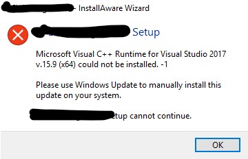

It seems like anytime that I change anything with the way our products are run through the Authenticode Signature or even going from the InstallAware X15 32.10 to 32.23 that we cannot keep using the already built (+signed) microsoft visual c++ runtime for visual studio 2017 v.15.9 (x64).7zip that was signed with 32.10 as during the installation it throws an error:
At another time when the timestamp server I was using stopped working and I switched to another the installation failed also.

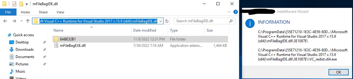

I've confirmed the Runtime gets extracted into the C:\ProgramData\{GUID}\Microsoft Visual C++ Runtime for Visual Studio 2017 v.15.9 (x64)\mFileBagIDE.dll\6ABE32B1 fine as "vc_redist.x64.exe" and I can run this file with the same options the "setupVC1416_27012_x64" has without any error. I've tried adding "/log <logfile>" into the "setupVC1416_27012_x64" to see if that shows anything but it is almost like the file never even gets run.

Does the InstallAware code for "Run Program $VC1416_27012_FILES_X64$\VC_redist.x64.exe" do some sort of weird check on the file or did the "Define File Bag :" not actually find the VC_redist.x64.exe to run?
As a follow on I changed the setupVC MSI script to show where it expects to find the vc_redist.x64.exe. This is the issue in that the new installer is not pointing at the right location it appears:
