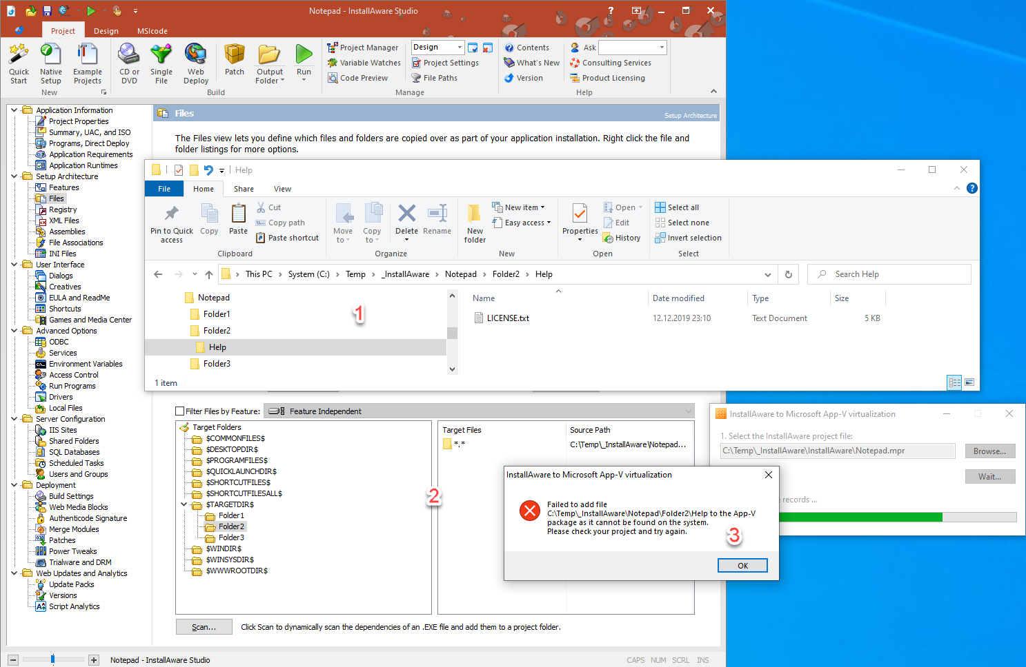

Try to build a setup using a small project using Installaware studio (x14 or x15 makes no differences, same result):
The project (attached as *.zip) has the following structure: (Mark 1 on printscreen)
Notepad (Rootfolder)
- Folder1 (Subfolder) contains file notepad.exe
- Folder2 (Subfolder) contains no file
- Help (Subfolder) contains file license.txt
- Folder3 (Subfolder) contains file license.txt
We are using wildcards to add subfolders and files in these folders (Mark 2 on printscreen)
A single file setup builds the correct result.
convert the same small project to an App-V package, result in the error "Failed to add file" (Mark 3 on printscreen)

I would like to ask again the @installwareSupport what they plan to solve this issue?
This is a clear bug, as the correct install definition of InstallAware is not converted correctly to the App-V package. But Installaware has a 3rd party tool included which they probably cannot fix themselves (https://www.gridmetric.com/products/libv.html).

For what I can tell you, the problem seems to be caused by the "help" folder under "..\_InstallAware\Notepad\Folder2".
If you try with replacing:
> "..\_InstallAware\Notepad\Folder2\*.*
with:
> "..\_InstallAware\Notepad\Folder2\Help\LICENSE.txt"
...it works.

yes exactly. As you see, this fact was reported in the initial post
... We are using wildcards to add subfolders ...
this is the typical use case for the delivery of a help environment which includes a set of generated files. There we cannot work with "hand selected single files". This means, it's not a valid workaround for our use case.
