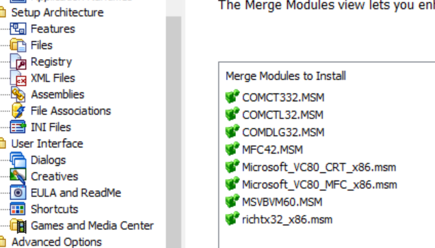

I've added the modules as pictured in the attached images.
In InstallShield I had to add the modules I needed and then assign them to an installation step for them to install. Nothing in the InstallAware documentation talks about a second step after adding the modules so I'm assuming there isn't one needed.
In testing I've set up very simple projects with just a module and one other file and it still fails to install the files.

I'm testing on Windows 11 24H2 OS Build 26.100.2454
Re: Merge Modules - Where are the files installed
axisuser wrote:I set up a new 'native setup' and 'single click setup' and still had the issue. I'm confirming the issue by searching the C: folder for the needed files.
Sounds like this is the issue, you're using the Native Engine instead of the Windows Installer engine.
Merge Modules are only supported with the Windows Installer engine.
You can try again setting NATIVE_ENGINE to FALSE?
If you are unfamiliar with this process, I would recommend you look at sample code found in a Windows Installer engine based template.
Usually the Native Engine is disabled, unless it has been enabled explicitly with a Set Variable command.
You may also need to set the NO_MSI compiler variable to FALSE if it has been set to TRUE previously.
Again, the default for that compiler variable is FALSE.
