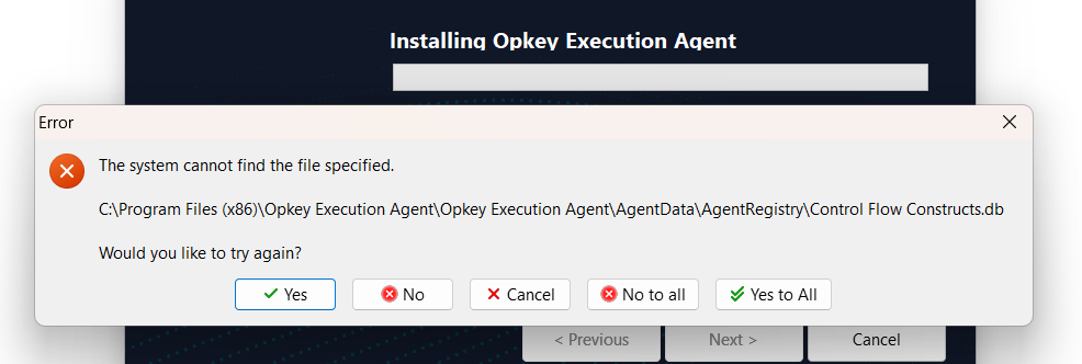

I'm using InstallAware Multi-Platform for Windows. My installer works fine most of the time during installation, but occasionally I get this error:
'The system cannot find the file specified.'
Because of this, the installation fails. It's hard to reproduce since the issue occurs randomly.
All the required files are included in the installer, so I don't understand why this error happens.
I don't think an antivirus is causing it either, since the error doesn't occur consistently.
Could you help identify possible reasons for this issue?
[img] [/img]
- Screenshot 2025-05-14 005440.png (48.71 KiB) Viewed 902 times

I have fixed all the issues. Please note that the issue does not reproduce in debug mode or uncompressed build. It only reproduces in the compressed mode build.
If you first install using the uncompressed mode, especially in C:\Program Files (x86), and then uninstall it, the installed file is not deleted because I haven't implemented uninstall with uac logic. Please manually delete the file from that location. If the installed file remains, and you later install using the compressed build, the issue does not reproduce.
However, if you install using the compressed build directly in C:\Program Files (x86), the issue does reproduce.

I think you still have some important issues you need to resolve.
For example, if you install as admin, but haven't implemented escalation during uninstall to admin; then it is only natural that the uninstallation and/or repair would fail with messages (similar) to the one you have shared - seeing as the non-elevated uninstaller would not have rights to access files created by the elevated installer.
You're creating a lot of artificial issues by not finishing the implementations of ideas you have undertaken.
As it stands, I don't even know when the error screenshot you shared is occurring, and am speculating about causes and conditions.
Please fix your implementations and test them thoroughly in all scenarios to avoid going around in circles with avoidable issues.
A tip that might be helpful in your scenario is using persistent variables to store the elevation state of setup, so when it has been launched in maintenance mode, you can elevate if necessary (thus facilitating elevated uninstalls).
Our philosophy here is to elevate at start or to never elevate, as we find elevation prompts served at the 11th hour distracting and bad user experience - especially as we strive to build installs which can complete unattended (that includes resuming from interruptions such as broken server downloads unattended) and don't require constant babysitting with never ending new prompts for user interaction that have been delayed for no good reason.
