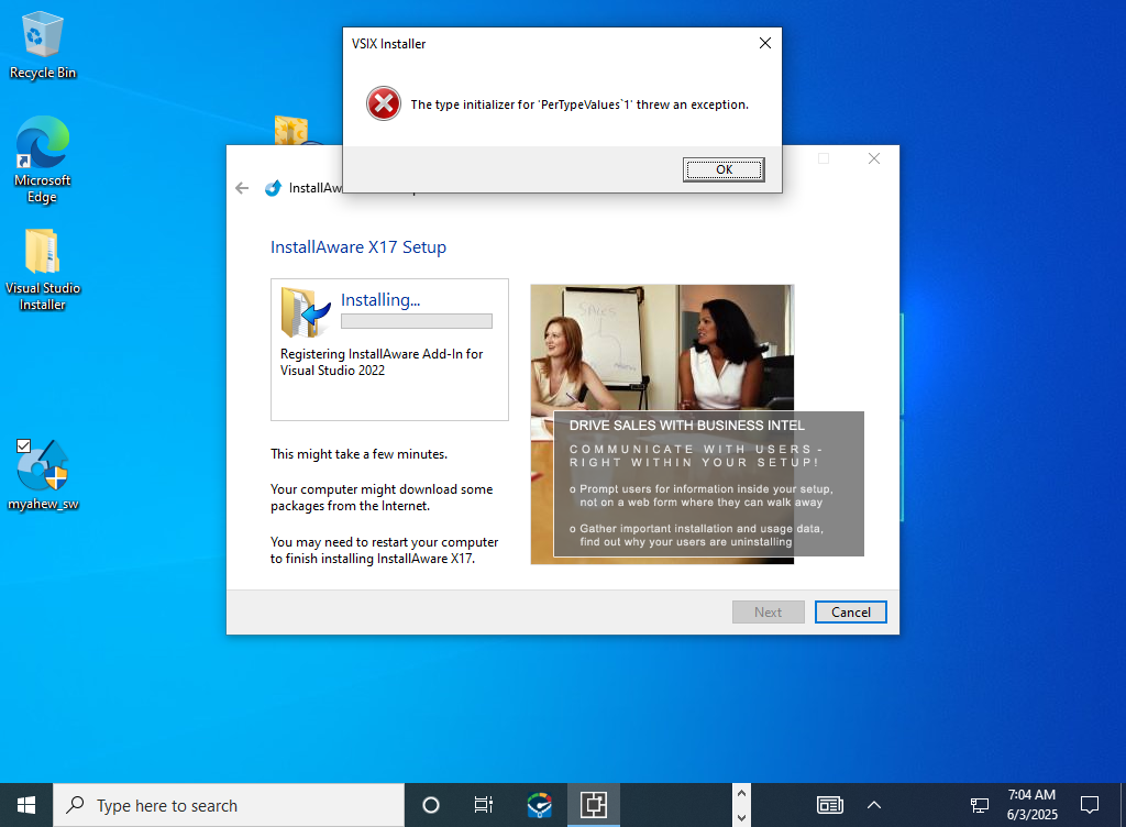

Re: InstallAware X17 Free failing to run
So with the "default" workload (not selecting anything and installing just the IDE), I get this error (from Visual Studio itself) during the Add-In registration phase (regardless of whether I choose it inside the VS IDE or the IA setup):
Since the VS project is constantly evolving, may I suggest you bounce this back to them to see what's broken at their end?
