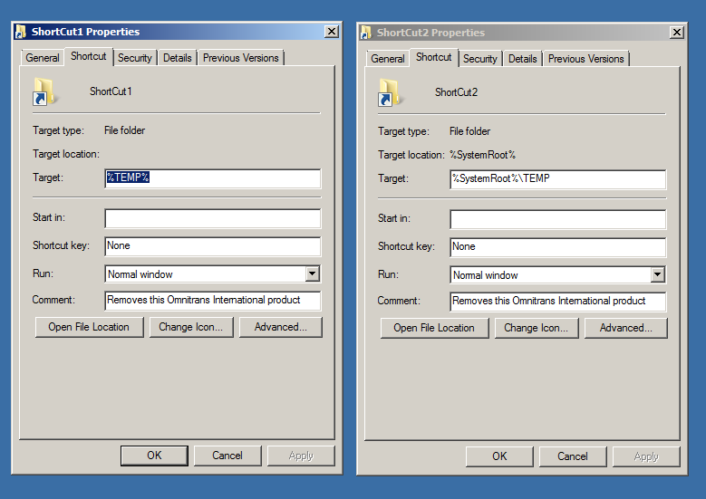

Dear Jeroen,
I have just tested your project ... but it doen't contain any %TEMP% definition with the uninstall shortcut.
Anyway, I have added two additional shortcuts to your original project as follow;
1# ShortCut1 - uses %TEMP%.
2# ShortCut2 - uses a custom variable ENV_SYSTEM_TMP that holds the value of the "TMP" System Environment variable from; "HKEY_LOCAL_MACHINE\SYSTEM\CurrentControlSet\Control\Session Manager\Environment".
These are my results!
You find attached a copy of your edited project.
- InputTest.zip
- (1.79 MiB) Downloaded 389 times

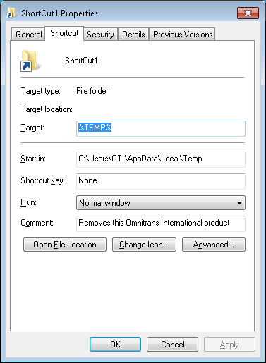

Re: prevent %TEMP% replacement
Dear Francesco,
You're correct when you enter %TEMP% into the "shortcut to File" in IA (see IA_shortcut_1.png), but when you put the same value in the "Startup In Folder" the value gets replaced (see shortcut1.png).
Best regards,
Jeroen
Best regards,
Jeroen
- shortcut1.png (13.48 KiB) Viewed 6233 times
- IA_Shortcut_1.png (16.09 KiB) Viewed 6233 times
