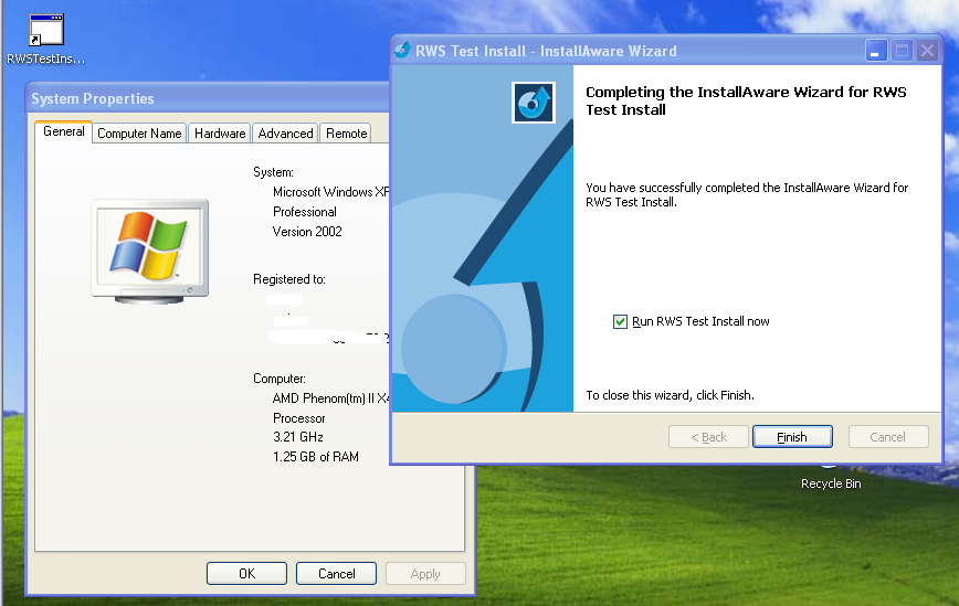

Well, we have made no further progress with replicating this issue in-house, however we are starting to see more and more of our customer base run into this problem.
Customers receiving this error are mostly on Windows Server 2003 and Windows XP, however we have had some instances on Vista and Window 7 and that is a concern.
To try and troubleshoot this, we created a new install using InstallAware 18 from scratch using the InstallAware Quick Start Wizard that delivers a simple executable (with no functional purpose.)
We then had one of our customers experiencing the error run this new installation and found they got the same error.
This install is attached (project and exe) and contains no custom add-ins, dialogs or resources.
Right now, we are having to create special builds for these customers using InstallAware 2012 and we may have to revert back to this version for ALL builds, but obviously we would prefer to remain on the latest version of the InstallAware product.
Regards,
- Aaron.

Re: IA17: Not enough storage to process: XP only
Dear Aron,
yes, I have tested your package but it worked always fine.
I tested your compressed exe with both WIN XP and WIN 2003.
Note, I even tried your package with a very first release of WIN XP OS (without any service pack installed) and it completed the installation correctly (see screen shot).
